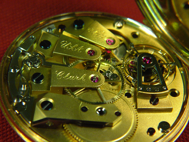

I thought I'd give all the PW fans a treat with a few pics of something I had in the shop for repair and servicing recently. This is quite a classy piece of work.

Magnificent One Minute Tourbillon cased in 18K Pink Gold

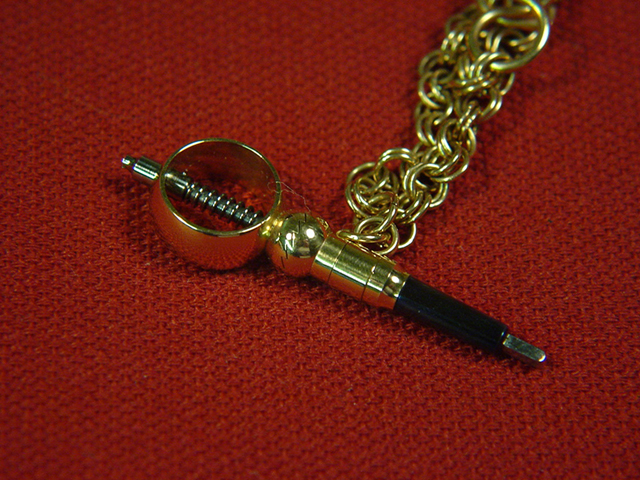

And it's 18K and steel, ratcheting, winding/setting key...

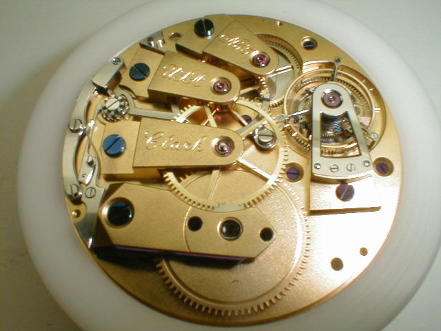

Not a great pic, but you can see everything.

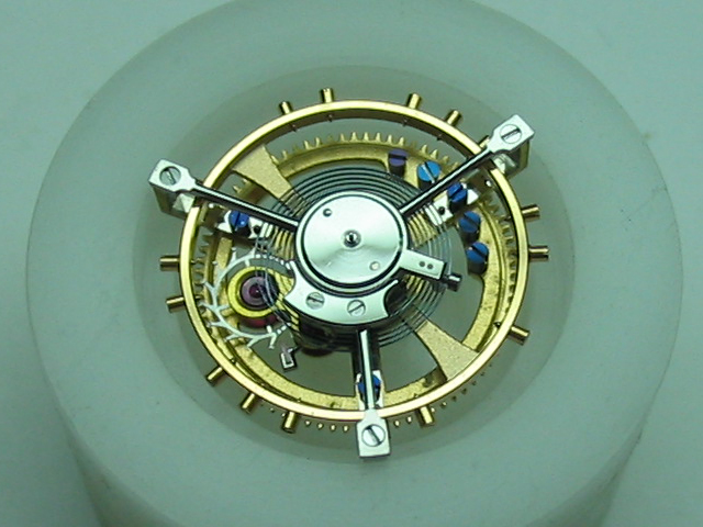

Phillip,
I got sidetracked after posting the first 3 pics, but now I have some time for a few details. This is Clark #5, a handmade Tourbillon pocket watch, (totally from scratch), and was made by Gene Clark of Colorado during the 1990's. The 24K gilded movement is of Breguet styling and is KW,KS. It is a one minute Tourbillon, with a lever escapement, and it is 18,000 BPH. The three armed carriage is fitted with shock settings to protect the staff of the mono-metallic balance which is fitted with a Nivarox hairspring.
This spectacular piece has several very unique added features. The mainspring barrel is totally "flying". A hack mechanism with a castle wheel arrangement is used to stop or hack the entire carriage. And, also very fascinating is the regulator which has a screw to tweak the outer regulator or curb pin inward to advance the rate. This watch is quite capable of holding a rate of +/- 0.5 sec in 72 hours!
It was a real pleasure to work on something of this quality, especially considering the fact that it was completely made by a single American.

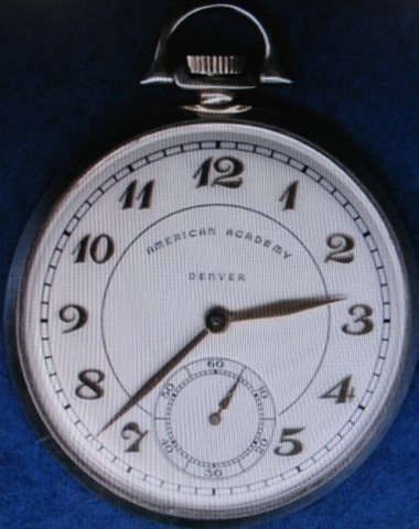

Gene, This may not be relevant at all, but The American Academy of Horology (or somesuch) in Denver gave their very first "hand Made" watch to Harry Truman
April 17, 2008, 12:43
Was or is Mr. Clark in any way connected to that school? Also in comparison to this beautiful work of art and machinery by Clark, how much of the Truman Watch do you think was actually "made" by the school?

David, regarding your question about the Denver Academy, I don't believe Gene ever had any affiliation with them. If he did, he never mentioned it. Regarding the "Truman Watch", and the extent to which it was "hand made", I have to say I just don't know. I will say that the layout seems strangely familiar, but Frank is probably better equipped to speculate as to whether this watch was potentially ebauche, or not. I notice that the pillar plate appears to be engine turned, but equally of note is the fact that the bridges appear to only have some straight graining. Also notice that this graining is going in two different directions. That possibly denotes that a student may have done the graining, while overlooking the need for all the lines to go in one single direction. And, if it's not just a glitch in the photo, there doesn't appear to be any graining on the balance cock. Hard to say, but I'm inclined to guess that this may have been partially done as ebauche and finished/fitted at the school. Hopefully Frank can enlighten us.
Frank, I totally agree with your comparison of the red, white, and blue planted on the Moon. The amazing part of both these exercises is just plain "getting it done". I equate the engraving of USA on the 3rd wheel cock of this magnificent piece to the American flag planted on the lunar surface. I should note here that this is attainable my many of us, if not all. Gene received no formal training as a watchmaker. Like myself, he was totally self taught. We also shared the fact that we both "cut our teeth" long ago as custom gunsmiths having learned machine work, fitting/finishing, and polishing techniques on fine firearms.

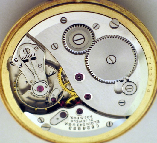

Frank, maybe that plate design was the "student watch" that was part of the institute's course work. I pulled those pictures from the NAWCC slideshow on "president's time" or whatever they call it. They have about 70 or 80 pictures of Presidential timepieces, including a Breguet (I think) that George Washington had.

I too think that the student watch layout looks familiar, and also looks Elgin in origin.

The Clark is fantastic. The Truman watch does look like it had its roots in an Elgin. The bow looks like Elgin's "Corsican" bow, so named because it supposedly was shaped like Napolean's hat. I likely am imagining it, but I suspect the movement was based on an Elgin Grade 543 (see below), which Elgin was producing while Truman was president.

Ethan,
I think you're on to something here. If I knew how to construct an 'overlay' in Photoshop, I'll bet it's a near perfect match. Even though the bridges are slightly different, that's a minor difference. The third wheel placement is within the barrel bridge, but the actual wheel train layout appears to be very close. Obviously, and depending on the actual production process and "rough" movement plate and bridge result, the upper third wheel pivot could easily end up in the train bridge where it exists in the Academy's bridge layout. The initial pointing and boring process of production would have likely been done with both bridges being "as one", and then the train bridge could be "parted off" in what ever shape and configuration that was desired at the time. It could either contain the upper third wheel pivot, or not.
Other strikingly similar characteristics are the "click" relief/recess in the barrel bridge, the actual shape of the click, balance cock, and even the pallet cock shape that is visible in both images.
We can certainly give the Academy the benefit of the doubt and assume that they possibly obtained a set of blueprints and worked from there. However, that would have involved a much more elaborate/expensive machining inventory that is generally beyond the scope of a school or adademy.
