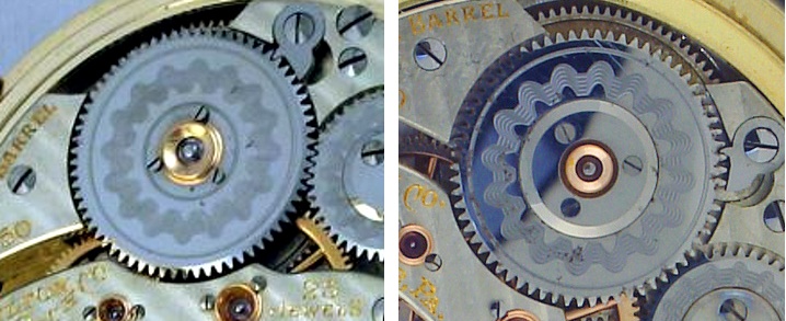

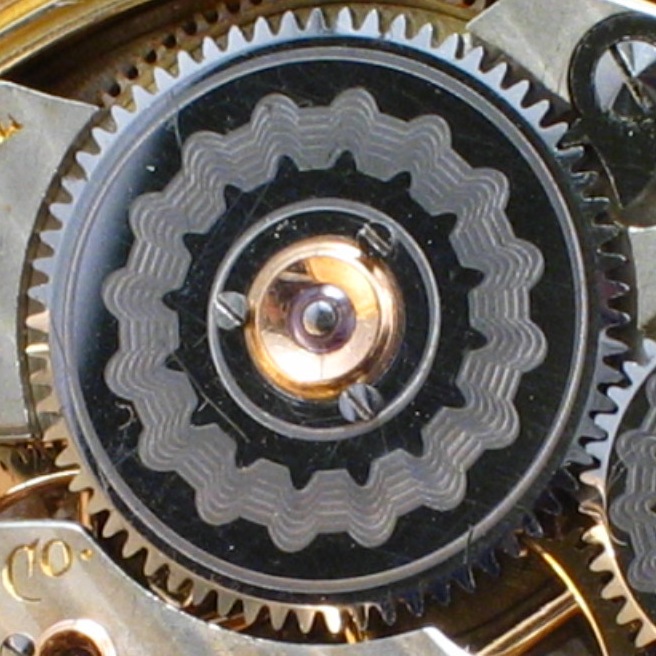

The 1st both 950's one without the washer & one with.

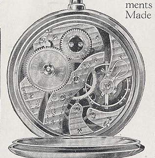

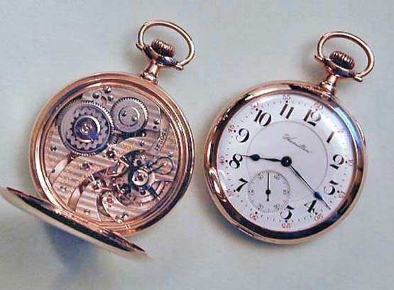

Another ad from elsewhere on the site.
I guess I could look for another ratchet wheel that will accept the washer but it would appear that they were also made without.

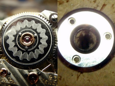

Got my new main spring from Brian today & got the movement back together & running.
After putting it back together I again checked the washer & besides the screw holes being to far out I also discovered the jewel setting is larger than the diameter of the washer hole.
After seeing the ads I posted above it would seem to me that Hamilton made these both with & without the washer. Most appear to be with the washer, at least the majority of the photos have them.
Here is mine back together & also the new washer I bought.

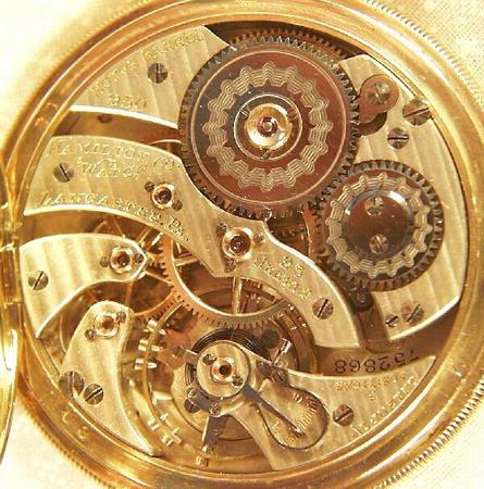

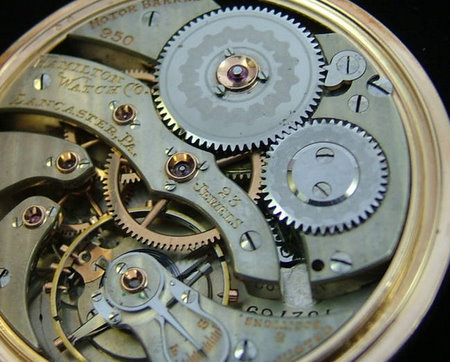

Found one like mine listed on ebay that is 119 numbers later than mine but from the same run.

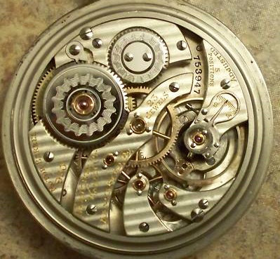

Here is another, 1060 before mine.

Here is a cropped version of another Hamilton ad from 1925, it also does not appear to have the washer.

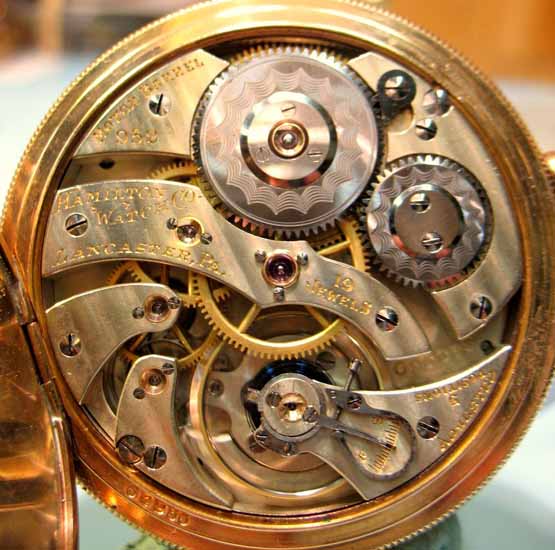

Another movement

Tom, from my engineering background I would say the second picture was never made to hold down a second item like the first one is because the screw heads are counter-sunk. Yours appears to be a two part recessed for the jewel hold down where the other is not recessed so the hold down is on top of the wheel. In my opinion the one you have appears to be a better engineered solution, may not be the most common but in my book I would prefer yours over the other solution.

With all the evidence you have presented, it sure looks like yours should not have the washer.

Before we proceed it might be important to recognize that each of the four examples of artistic renderings or drawings that Tom cited are in fact the very same drawing shown four times. That is easily established by the shadows and other details in the drawing. Remember that is not a photograph of a watch but rather an artist's conception. Often the artist drew something that differs with the actual movement which may have occurred in this particular instance. I could cite a number of examples of perceived artist's errors including an ad where the manufacturer's name is flipped over in the opposite direction from how it appears on actual movements.
Next we must recognize the pattern on the wheels in that drawing Tom shared is not even the 950 style of damaskeening. That causes me to question the accuracy of the drawing that shows no cover and whether Hamilton ever actually produced movements without the barrel cover in place, my feeling is they most likely did not. Looking more closely at the "1919 Red Book" ad which is taken from page 31 of the Ehrhardt Hamilton book and the drawing on the lower left example in that ad which shows a jeweled barrel with cover in place is somewhat closer to what we would expect to find in other Hamilton advertising as well as on actual watches.

752868 1910 (no cover)

753947 1910 (no cover)
