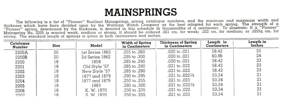

May 22, 2011, 15:13
Jerry King
Hello Paul....
Here is a portion of pg. 29 of my parts manual....
Pay close attention to the ordering instruction at the top of the page since it is using Main Spring #2205 as an example....
This is the only information I have therefore you will need to make whatever assumptions you can from it....I hope this helps you....
