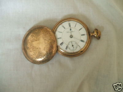

This was the item description:
"The watch is a gold colour and the front and back has a scroll style patter, the front has come off but should be easy to replace,, the faces says Hamillton, when you open the back it says Premier 503278 the movement is marked Wolff Fink lead P d 17 jewel"
And that's It as far as the burb went - except there's no text anywhere on the movement that says 'Premier' - it's actually engraved on the inner Cuve!.
The listing photo is below.
I have the watch here now, but my camera batteries are flat, so will upload good images later on as long as the site is still up.

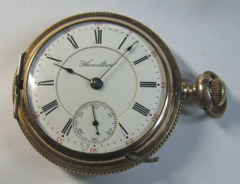

John WoolseySome photo's finally, hopefully I'll be able to post better quality pic's when I get my head around all the settings on my camera!
I tell you what David, with my track record of family history research, if there's any Ghosts lurking around this watch, they'll make their presence known at some point!
The case appears well brassed in the photo's, which isn't actually so, it's quite even in colour all over.
If anyone has a suitable index lever going spare that could be plated, I'm all ears!
1st up is a shot of the dome.
John
February 03, 2009, 13:54
John WoolseyDial shot, I've left off the dome, which needs the hinge tube replcaing.

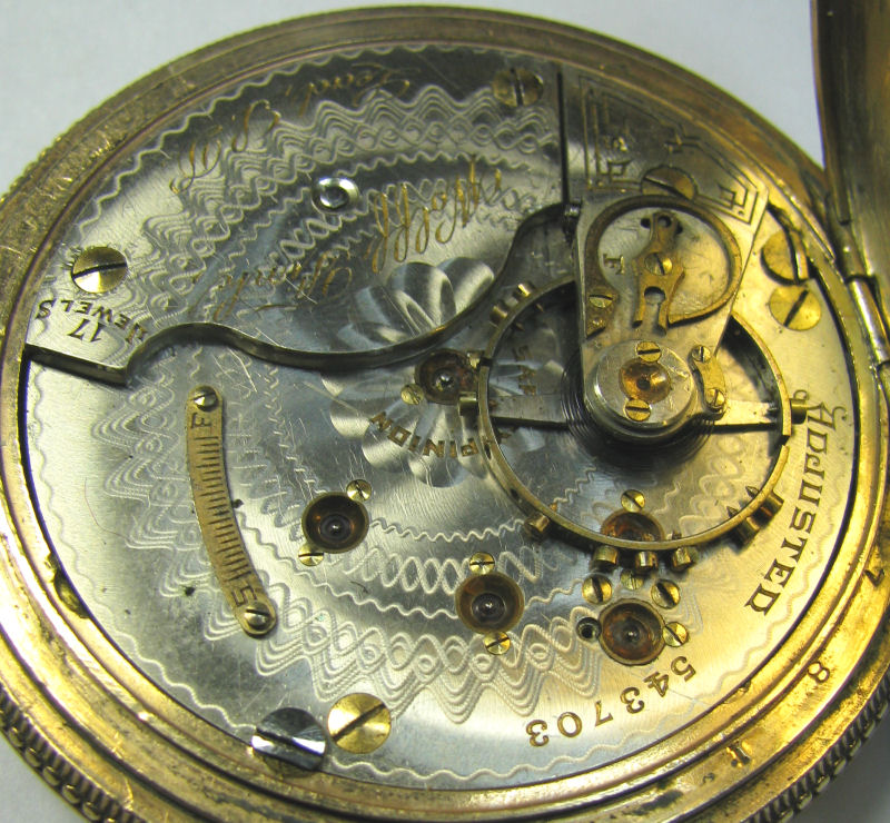

John WoolseyA few movement shots
John
February 03, 2009, 13:58
John WoolseyMovement 2.
John

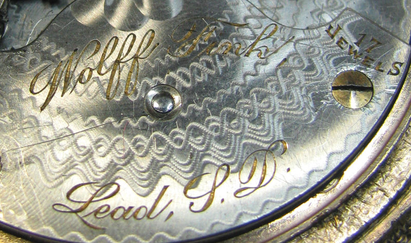

John WoolseyName Engraving.
John

John WoolseyI've noticed the extra case screw mark, so this may be a recase, but everything lines up spot on, and the movement fits like a glove.
When I get a bit more time, I'll dig deeper into the movement and see what's bust on the staff - hopefully no jewels broken!

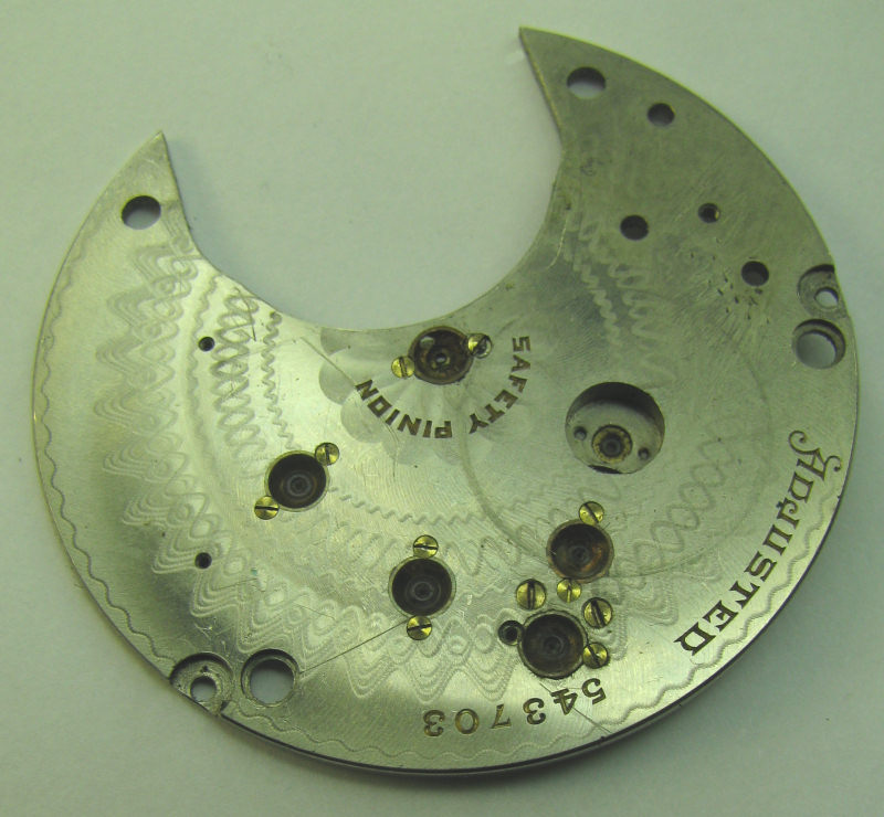

John WoolseyWell, with many thanks to Brian C and Chris Abell, I now have most of the bits needed to revive this beauty.
Got around to stripping it and taking some photo's of its road to rejuvination, and quite an interesting hike too!
These pic's just show some of the foibles of an eBay purchase, and possibly a 'doctored' watch that didn't quite make it!

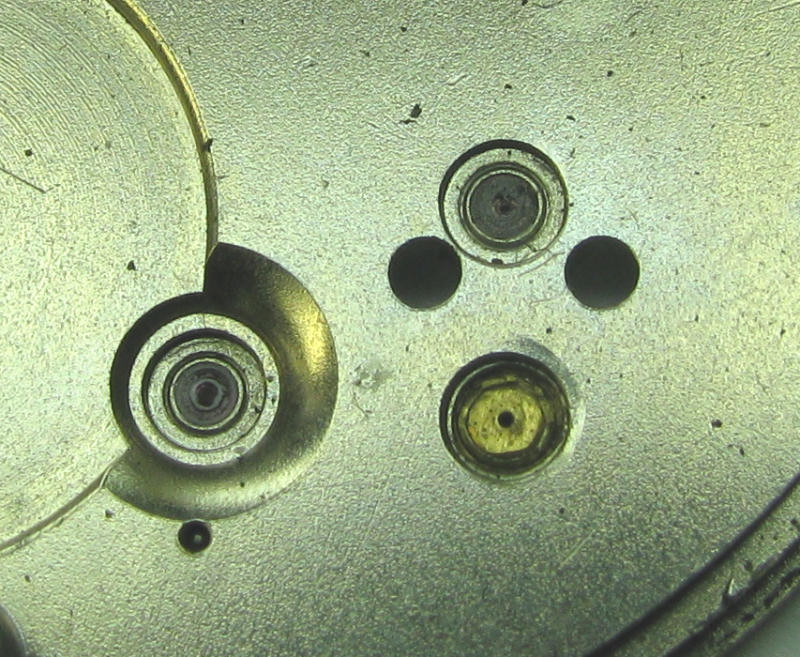

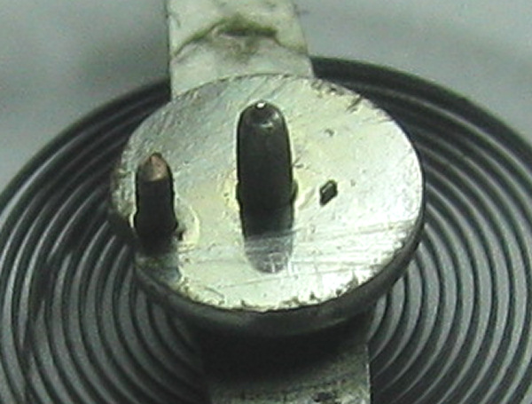

The roller jewel had been replaced by a brass pin rammed into where the jewel should have been, but the other main fault apart from the broken staff and escape jewel, was a broken jewel on the dial plate, which has been chewed out and replaced with a brass bush!
Somehow I've to create a complete jewel setting to replace this botch!
Will update further down the line as it progresses.
John
1st phot up is the mangled roller table!

John WoolseyInteresting replacement for a jewel setting!
JW.

John WoolseyBalance removal uncovered broken as well as the missing gilt screw!
JW

David AbbeJohn, If the escape wheel end-play governed by that "bushed" dial plate "jewel" is still OK, it may be best left alone. I would concentrate on the important (broken) stuff first and then consider;
1. Leaving that as part of the "ambience" of the piece.
2. Use a top plate mounted jewel that fits the Escape wheel pivot and very carefully thin down the mounting and re-fit it in the dial plate for correct end-play.
As for the roller, I suggest that you get a new roller to replace the one so barbarically disfigured, as I would not trust the size of the roller jewel hole to be correct any more.
February 21, 2009, 12:14
John WoolseyThanks Dave, to be honest, I'm inclined to go along with you on the brass bush replacement - sort of on the lines of 'if it ain't broke don't fix it'
Problem for me, is when I come to dispose of the watch, I wouldn't rest easy leaving a gash repair like that in place, and owning up to it would destroy it's value some I think.
I'll certainly ponder over that whilst sorting out the other stuff, although the watch does deserve being 'done right'.
I got a new roller table and jewel from Brian along with the staff, so that part at least is sorted out.
I mentally 'binned' the table as soon as I saw it ........ after I'd gotten over groaning about it all!
