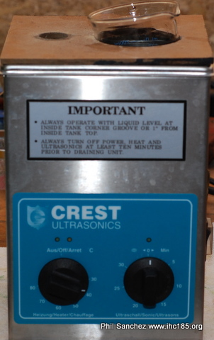

I have had good results, but it also could be due to the fact I am not using a super heavy duty ultrasonic. My Ultrasonic
As I said above I would post a dial before and after, the results show up good even with my poor pictures. This was using Mean Green in the Heated cleaning for 180 seconds. I use a glass open mouth beaker to hold the dial in the cleaner, the beaker is in water in the ultrasonic. Not even a hint of green left in the lines.
