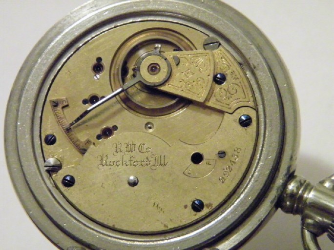

I bought this one because I have not seen the pendant/lever switch function before. The watch, while not perfect, is running well. The dial is very good with no faults. The switch screw is missing and so is locked in the lever set mode. What was the benefit or advantage of being able to change from lever to pendant set and vice versa? What is the purpose of the little screw just above the serial number? Here is the movement.....

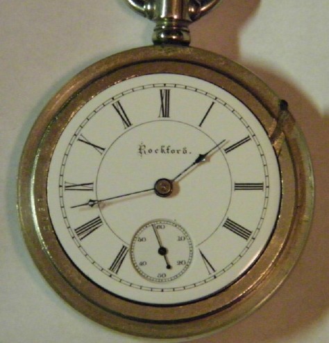

The bluing is mostly gone from the minute hand. Here is the dial.....

Nice Grade 67, made in 1887, Mary Ann....Why the combo, my guess would be as a marketing tool....gives the buyer an option of the lever or pendant convenience in setting the time....
Others will probably tell us the real reason though....

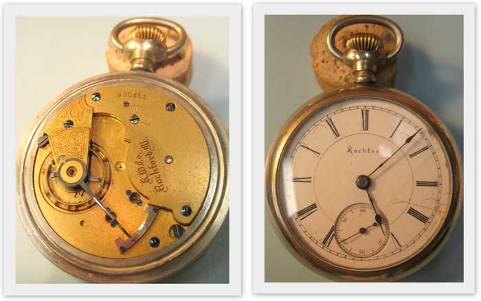

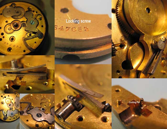

Mary Ann I share your curiosity of both HOW and WHY the Rockford S/L is doen. A quick hunt through my "rummage" produced this thing with Jewels on the 3rd and 4th wheels??? Usually with this jeweling, of "paired" jeweling, they would be on the 4th and escape wheel. So as old Jown Wayne used to say "Waaall hear ya go again" (Pictorial report to follow)

I have always been told that when a watch company was trying something new (lever set to pendant set) or ( key wind to stem wind) most of the time they did do both, for a while. Just in case someone bought the watch and did not like the "new way of doing things" It could be changed back with a turn of a screw. This was also done on the keywinds to stem wind. There are a few pocket watches out there that do both. I know there is a 18 size Illinois that does both. This is called a transition watch. Not sure about the others. Not sure if this is right or not, but that is my 2 cents.

Well, from servicing this "thing" I can share four things that learned;
1. Watchmakers removed the parts for the "S-L" from all 6 of the Rockfods I have with the attested function.
2. Rockford created a monstor trying to satisfy their marketing dept. Mebbe that helped slow their sales inertia and eventual demise. . .
April 13, 2009, 20:26
3. This is a 9 jewel watch with two jewels in the least "appropriate places.
4. It cleaned up and runs quite well.

I tried to sketch out from the few parts left in the movement as to how I saw this one to work and it still did not make sense because the screwed down parts would have to move the wrong way. I think that it required a special winding stem held in by the retainer pin, and that stem reacted in some magic way to the flexture squishing when a cam action on the L-S was activated. Roll Eyes

Dave, I think I understand what you just said Confused Maybe after the class in June it will make more sense to me. I would be glad to send mine to you and let you look at it and compare to see if it has more of the mechanism parts. When I look in the missing screw hole, there is something on the pillar plate that looks like where a pinion would go, I think. Let me know. And, yes, it would be nice to find a complete one. I will keep looking.

Steve, the parts that are left out faciitate changing from Lever Set to Pendant set, leaving them lever setting only.
