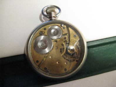

February 06, 2014, 21:44

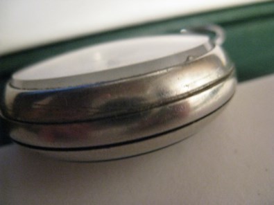

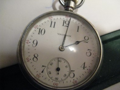

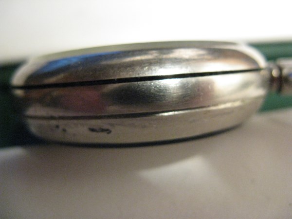

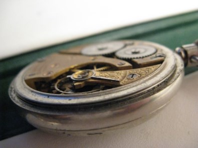

Bill Manders
Hi all,
Here is a picture of the case
Bill
February 06, 2014, 21:47
Bill Manders
#2
February 06, 2014, 21:48
Bill Manders
#3
February 06, 2014, 21:49
Bill Manders
#4
It is the dial side I am trying to remove.
Bill

February 07, 2014, 07:47

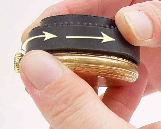

Phillip Sanchez
Bill, from you photo it sure looks like a screw down
bezel.
As another suggestion rubber gloves also work well.
I have had success using the rubber gloves in combination with the this ball
February 07, 2014, 13:16
The large gap that is already showing on the Dial side bezel tells me this is cross-threaded and will "pop" off with a little persuasion from a case opener. I Have seen this before on cross threaded case covers and the gap means that by levering the bezel up at several points chosen progressively around the diameter, you will ultimately get the cover to release and come off.
When the cover is removed, I suggest smoothing the threads on the case and bezel with a screwdriver tip, especially near the "lead-in" where they may have been distorted when forced to screw together in a cross-threaded condition.
