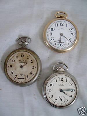

Hi just purchased this off ebay. The seller did not have very much information. Any guess on what the illinois is?

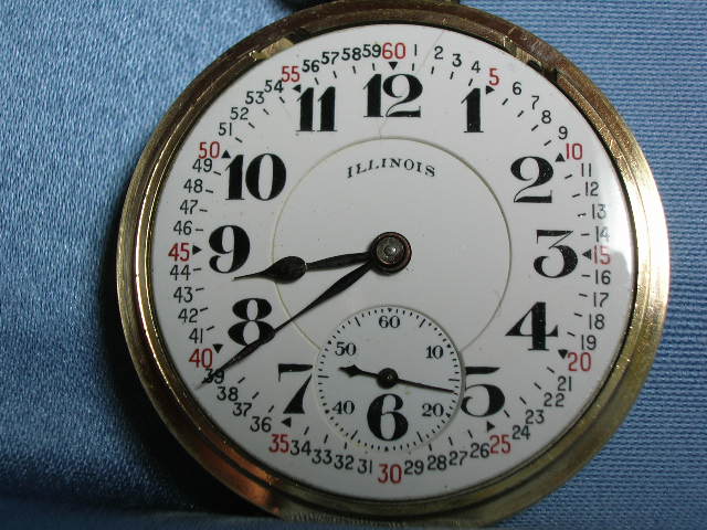

From the perspective it could be a 16 size, and the "faux(?)" double sunk Mintgomery Dial suggests that it can be RR grade. No telling til you get it tho. The hands look good for that fact too.

Both the Double-Sunk porcelain-enamel dial and the hands look like they are probably correct. Getty movement would be unlikely with that dial. Could be an A. Lincoln but most likely a 21-Jewel Bunn Special. I would expect to find a non-60 Hour movement but you could get lucky and find a Motor-Barrel 60 Hour. My bet is a decent, original watch. You have rolled the dice and won before, so good luck on this one.

Well it is a 21j Bunn Special #3951010. Nice doulbe sunk Montgomery Dial with one hairline at the 12. Hands are OK. The seller said it did not run but it is keeping good time. The trouble is it will not wind, the hands set when the lever is out. The case is very nice Keystone Jboss 10k gold filled.

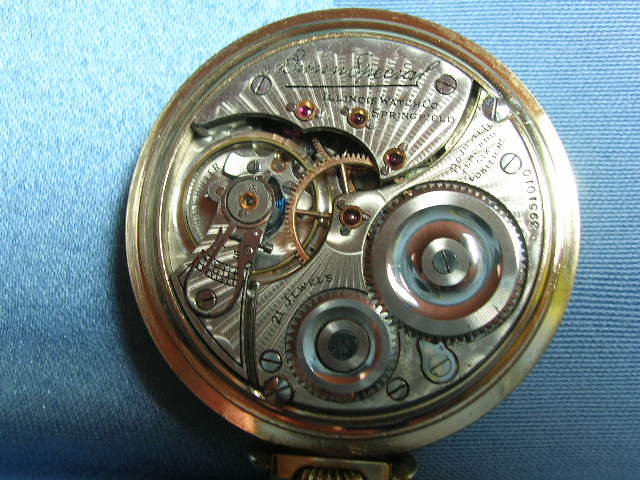

Pictures of the Bunn Special
March 07, 2009, 09:07
Keith Klimkowicz
Movement
March 07, 2009, 09:12
Keith Klimkowicz
I did try using a longer stem to wind but it would not engage. I still think it is a spring which holds tension on the gears which engages the winding gears.

Steve Middlesworth
Keith,
When you set the time, does it have any slip of the gears? If you remove the dial you can see a gear that moves up and down near the stem that engages the winding mechanism. It may be the clutch spring is broken. When you move the setting lever in and out does it snap back in or do you have to push it all the way?
Steve

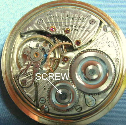

Keith, This is a beauty, good dial good movement and well worth making right for any collection of RR watches. If the Screw holding the winding wheel is loose (it is a left-hand thread), it will not wind, but may do the other things you observed. If that screw is tight and it will not wind, have it cleaned and serviced because the problem is under the dial.
