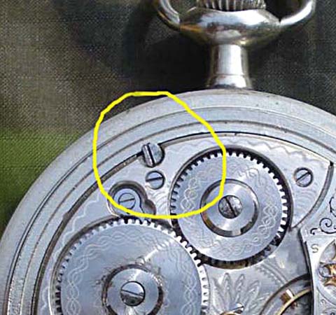

I was browsing eBay just now and came across a watch that apears to have been re-cased.
What I am wondering most of all is why is there a half-headed screw inside.
If anyone can tell why this is done I would really appreciate it.
I know nothing about pocket watches at all, but my instinct tells me that this appears to be shady.
Thank you.

Mark CrossHalf head case screw? No, those can be found quite easily, and were considered a 'better' screw as they would 'bite' into the case and be less prone to loosen up in use. A 'quick fix' repairshop trick.
Problem was, they DO bite into the case ledge, and cause those awful gouges you see on old cases. Sometimes after a lot of use, they actually cut the ledge out.
So, nothing shady. Just an 'improvement' in the repair process, or so they surmised.
Regards! Mark

My belief is that all screws were made completely round and movements were originally fitted with complete screws. Apparently, in order to speed the repair process some watch repair people would clip about a third off one side of case-screws, that way they need only turn them by one-half turn in removing and re-installing the movement. Close examination will confirm the clipped screws are roughly cut and not at all uniform. Many of us consider them offensive looking and as Mark pointed out they do serious damage in "gouging" cases, we try to replace clipped screws on our nicer watches.
Interestingly, there are many "quick-release" attachment devices made today, the ones I mention are spring-loaded and used in various fields including cameras, cars and motorcycles. A search of "quick release" brings up a number of modern day-products, some are high-tech versions of what was done to our case-screws so long ago.

Theodore J. Brown Sr.Hi Bud, those horrible half-head case screws are, as Mark and Lindell said, only good for ruining cases.They are the dumbest invention in all of watchmaking!By the way, the picture you showed is an 18size model 1892 Waltham, one of the nicest and highest-quality American watches.Whatever grade name or number that is, it's a keeper.Best Regards, Ted.

Eugene BuffardI agree with Lindell. You might see a lot of these half screws but they are not original. They are not polished on the cut side. And would not of been shipped from any watch co. As it states poor quality.
To take the movement completely apart you have to remove the case- screws any way.
My assumption is that a lot of shady repairmen did this to speed there cleaning time up. Thus not even disassembling the watches completely to clean.
When you do not disassemble the watch to clean it you normally have to clean it two are three times. To get them to run for very long.
So by cutting the screw they are SAVING A LOT OF TIME. DUH!!!!!!

Nothing shady, just a very poor unproven attempt to save time in the aftermarket of watch repair. The first rule of thumb in watch repair 101 is to never make shortcuts that can't be undone. So the watchmakers[if you will] were in violation of the basic rule
Now years and decades later, we are the ones that suffer
I ALWAYS try and replace half head screws with factory correct full head screws and THROW AWAY those half head screws. As a group we can make a difference but we may have to have some factory correct NEW screws made up, which I would gladly buy a 100 pc. pack right now for say $25-30.
