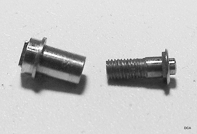

Derek RamsdaleThanks Dave, The pictures show how a small threaded piece of the lower arbor part, with the gear for operating the WI, has snapped off @ some stage.  This bottom piece screws into the top piece to form the complete barrel arbor. I`m guessing the gear was pressed onto the lower arbor during manufacture.
November 19, 2012, 11:12
Derek RamsdaleAnd the complete arbor - bottom should be screwed into top.

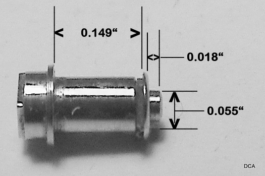

David AbbeDerek, A couple Key Dimensions to help you check if there is a chance that the little gear just pressesd on.

David AbbeAfter finding a W.I. Arbor on a Watch in here for service, I was able to do some more careful measurements . . .
November 20, 2012, 18:02
David AbbeIn comparing the two arbors side by side, it looks like the W.I. arbor has a "cap" that is either part of or just holding on the small W.I. gear. Since your arbor is already broken, I would be tempted to take a single edge razer and try working into the seam between the arbor end and the gear and seeing if I could "walk" it off the end of the broken arbor.
Otherwise, you are right, the end arbor part is completly different.

Derek RamsdaleOn closer inspection I`m coming to the idea that the gear has a collar ( all one piece maybe) & it is riveted onto the end of the lower arbor &  this collar  acts as the bearing. I can just make out a concentric circle where the two surfaces meet.

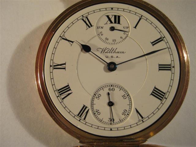

Derek RamsdaleThis is the face of the watch in question. You don`t see too many with Roman numerals. I assume it was made for the UK market.

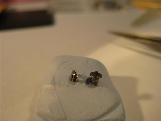

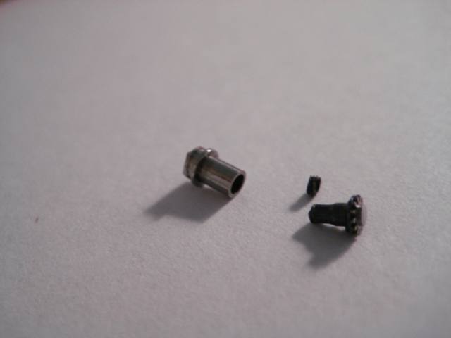

Derek RamsdaleNow for the surprise. I`ve found ANOTHER broken M/S arbor for a winding indicator watch. The gear wheel was relatively loose on the shaft & you can see the gear is substantial, with a collar an integral part of it.
Both broken arbors were hollow in the threaded area which makes me think its a weakness in design.( Not a good thing considering spare parts availability )
February 03, 2013, 12:47
David AbbeThe "new" broken arbor loose part should allow you to more easily fix your watch by fitting that piece to the replacement arbor.

Derek RamsdaleWell, the Waltham Vanguard WI is now fully operational after repairs  -- Thanks to Dave Abbe & Martin Walker, a clock & watch repairman from the City of York.
The 2 part M/S arbor now has a solid lower screwed part, to which the gear is press fitted, & hopefully stronger than the previous hollow piece.
