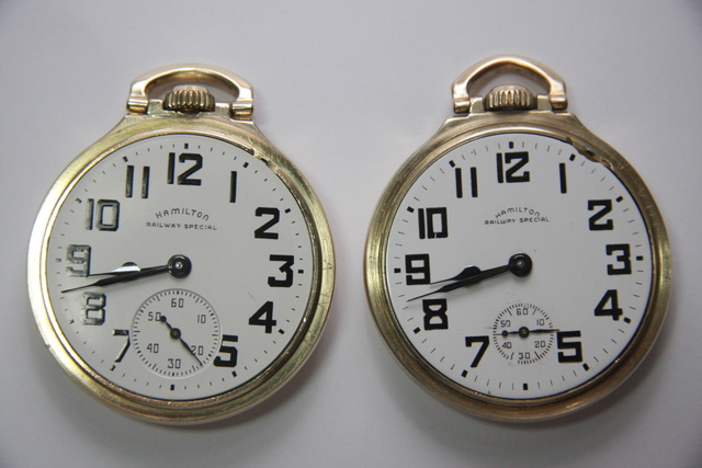

This is a little interesting as I am not really sure what I have here as far as the dial and case go.
On the left is a 1951 992B
on the right is a 1970 992B
Notice the difference in the dial, and in the bows.

My question is on the 1970:
1. Is that dial right?
2. Is the case the right case?

The 4C has a replacement dial. The sub seconds chapter is not sunk and too small in diameter making the seconds hand go past the circumference. The bow on the 4C case doesn't look right because it's bent out of shape and possibly worn where the edges make contact with the case frame. The writing on the case backs is correct because it changed over time and the later one has the correct Hamilton H logo. A melamine HG or BMN RWS dial and the later 4C watch will be correct.

Thanks Richard, I forgot to mention that if you look at the lever set, you can see a brass plate for the dial, and it looks like the dial is just painted on.
So a 24 hour dial would not work on this year then?
September 12, 2010, 06:47
Phillip Sanchez
Larry, My opinion for what it is worth. On the 4C take that crappy dial, sell it on Ebay. Change out the bow. Put your 24hr dial and those hands on the watch. What possible difference could it make if it is not exactly period correct?

I received the late model 4C 992B from Larry this morning [ see Larry's image above on the right ].
I straightened [lowered ] the bow,changed the dial back to original factory melamine, and took a couple dents out of the back of the case.
Now it's back to factory original Smile
Thank you Larry Smile

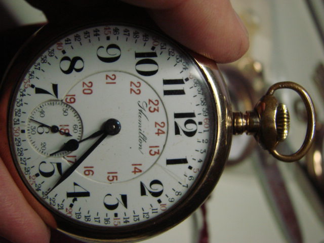

picked up this little number tonight, a 940 hamilton with a nice 24 hour Monty dial with a couple hairlines Frown
September 21, 2010, 22:44

John J. Flahive III
Nice watch Tom! Smile
I love the 24 hr Montgomery dials! Cool
How much do you want for it? Big Grin

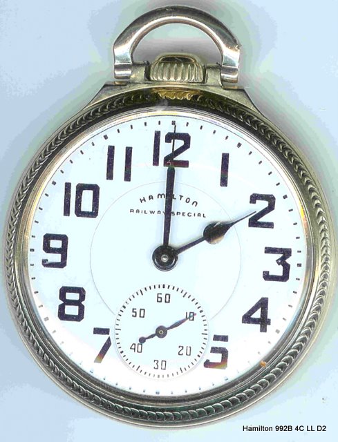

Hi I have a question,about Larrys 4c 992b.Was it shipped from factory with a 4992B piller plate?Or did some one do it out side factory?If it was done at factory,don't you think he has a winner?
Hub.
September 22, 2010, 09:09
Buster Beck
Hi Hubert,
The 4C 992B's were the final factory production or "cleanup" run that Hamilton made. Since the cleanup run consisted of in house, in stock parts and without rhyme or reason, and without any surviving records, we will never be certain how many 4C's are out there.
However since there were over half a million 992B's made, they are and will be in our lifetime, readily available. The 4C's will represent a "variation" that will entail a following in the years to come.
