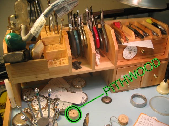

I use a cerium oxide paste that I load on the face of a piece of pithwood. Then use that to wet polish the glass. Mainly I do this when there is a haze from a "burn" on the glass from the label adhesives. The advantage (as I see it) using the pithwood is that the pressure of polishing is more evenly distributed over the glass surface thus reducing the possibility of breaking them.

Ok David, I can look it up on the internet, but have to ask. What is pithwood?

Dave would you mind selling me some pithwood?
