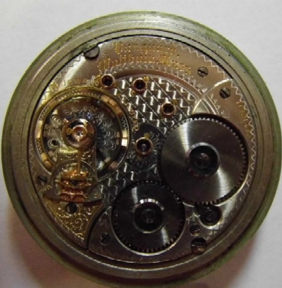

Hi All
Picked this up the other day off the Bay. The dial and that it is a 19j always gets me. After receiving the watch I did some research on the Grade 1892 Waltham 19j Vanguard. Finding it a not so common grade and the Waltham search site listed the serial number from a run of 23j Vanguards.
I would like to see if others have found mixed run information within the Waltham research site also. My serial number is 11501450. This is my first 1892 Waltham Vanguard, sure is a great looking movement. Can any one tell me the reason for the little hole under the balance wheel (around 7o'clock).
Thanks for any information.

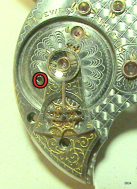

Please excuse my interruption. If we are discussin the hole circled in RED below, I need to explain that Waltham could not drain or add oil through this orofice as . . .
January 02, 2013, 19:57

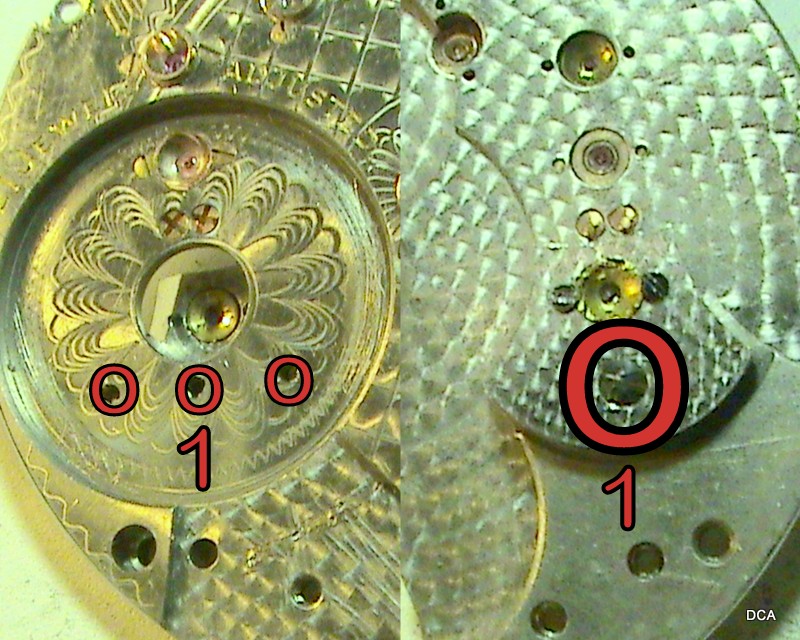

it is one of the two (2) locating dowel pin holes for the bottom balance jewel cock that is affixed to the backside of the train plate by a screw(RED #1 circled).(See below . . . the "naked" top and bottom view of the 1892 Train plate [of this design iteration].)
Any attempts to use this dowel hole as an oil fill or drain hole may not be rewarded by a "Happy New Year" of good time keeping!

Cheap Facet Cut Diamond end stones on the Highest grade Waltham and Elgin movements were "dressage" of very limited value.
Understanding the "whys and wherefors" of a "sometimes" visible hole (one of the three "visibles" when the balance cock is not on the watch) as evidence of various means to mount the bottom balance cock would be understanding WHY Waltham's earlier model 1892's had only 2 plate screws holding down the barrel bridge while later ones had three and in the process they changed the length of their pallet fork arbor making it a "stinko" problem to replace
Actually the method of attachment for the bottom balance cock was changed at least once and I think it was then changed back. Sort of like when a few 16s model 9 Illinois watches had reverse jewel screws on the balance cock which were abruptly dismissed as a worthy modification.
In some cases (excepting the Getty), I suspect very strongly that too often in the "later" years the heavily over structured watchmaker hierarchy created more and more of a "design by committee" "flavor" in these watches.
