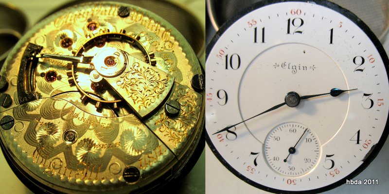

I took my 150 out of the case . . .

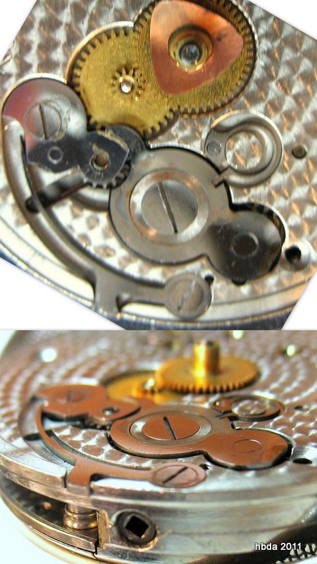

Pulled the dial and "shot" the Wind-Set . . . but alas, I did not read your request carefully as this is a Pendant set. Well . . . I hope it helps anyway . . .

Dave it is good that you did what you did since it makes it easy to show people if they only take it out of the case and it is a lever set but they see it has the notch that you took a good shot of and there is nothing there then it is a model 5 converted to a model 7. All 277's I have seen so far have the remnants of the mounting points and this notch that was made to fit part of the spring mechanism for the normal model 5 pendant set. If it doesn't have the notch and it has a serial number for a grade 150 then that is another type, but the photos help.
I have two of these lever sets that from the serial number are grade 150's but why would Elgin create a special grade (277) for less than 200 watches and not take these watches into account, if a lever set grade 150 was a valid grade 150 then why even create a grade 277. With the pictures maybe it will be easier to make sense of these strange lever sets.
