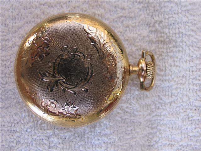

Case back

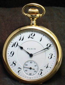

Here are the dial and hands on an OF Grade 162, #8,497,439, in a 14k Roy case.
April 18, 2013, 11:29
Ethan Lipsig
These four watches illustrate Claude's point that thin moon hands were correct for the 155/161 and thin spade hands were correct for the 156/162. Claude also said that "moon hands were correct for . . . the later 243/246 which was (sic) the 156/162's 17j little brothers." However, my Grade 243 hunter (#9,723,970, in a 14k Dubois W. C. Co. case) has thin spade hands.

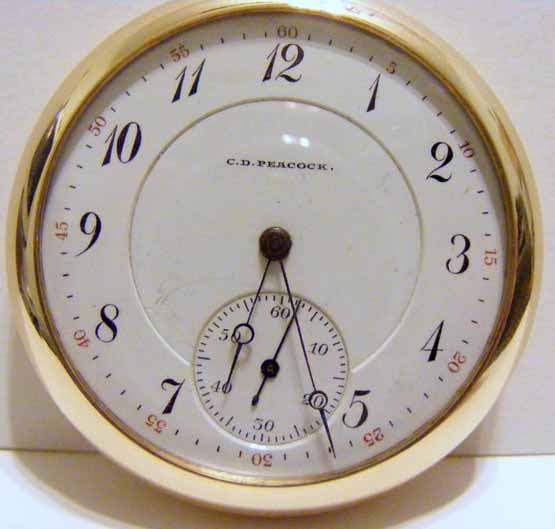

Claude Griffith
Here is my C.D. Peacock 246 with moon hands
April 22, 2013, 11:57
Claude Griffith
One added note you will note the style of the numbering being different between the 162 and C.D. Peacock dial I posted. I rarely see this style of number font on anything other than the 155/162. I think the only reason it shows up on my 246 is because it is a private label since this one would probably have the block Elgin font like Ethan's 243 dial post, or the same look but in Arabic form. And Ethan's 162 is even more stylized than my CD Peacock dial.
