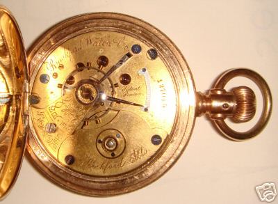

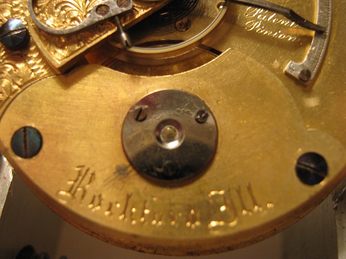

Anyone have knowledge on this style plate that goes over the mainspring barrel? I have never noticed the silver cap with the three (3) tiny screws.
March 04, 2012, 18:35
Theodore J. Brown Sr.
Jon, I don't know Rockfords well enough to know what model that is, but it's an early one.I've seen one like that with a cut-out to make the escape wheel visible.Nice movement!Best regards, Ted.

I dont have my rockford book with me. Therefore, like a fish without water. Trying to learn these Rockfords... Frown

Jon, That plate is a Key Wind replacement for the Key Wind reinforcement collar plate. I expect it was made to facilitate using up the last surplus of orphaned Motor Barrel covers machined for Key Wind on late "transitional" movements.
March 05, 2012, 13:51
Jon Hart
David,
Thanks... The contrast between the two metals draws your eyes to the barrel cover.

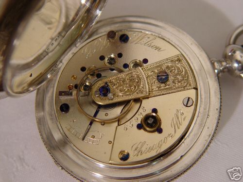

On the two (2) RF 18s movement we have posted, why did they use the different setup for attaching the hairspring? I have seen this setup on a few IL 18s, too.
On the hairspring attached to the movement plate, not the balance cock, it would seem the hairspring would be sitting low or increasing the chances of it "rubbing" on the balance wheel.

All later Hairspring studs are usually affixed to the Balance cock. Hairspring bridges on the movement plate were the early (and complicated) way to mount Hairsprings. This started because the earliest Hairsprings on Smerican Watches tended to be UNDER the balance wheel rather than above it. That required som nifty way to reach out inder the balance wheel and hold on to the outer end of the darn thing. Even this beautiful swiss fake Waltham 1857 style copied that early method.

John I had the same manhole cover on a similar Rockford and I agree with Dave. An interesting thing about Rockford is that there seem to be a fair number of Rockford transitional movements around. More than some of the other makers. Maybe they did not quite trust the stem wound system, but I assume they decided the covers were the most economical way to go to use up materials on hand when they went to stem ind only. They are attractive though.
