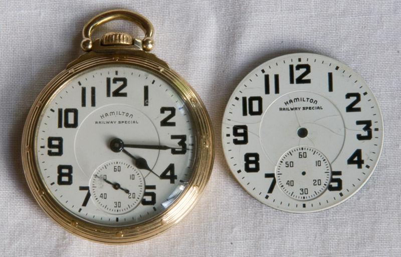

Here are a couple of photos of the watch in question (original dial on the right):

one more:
September 14, 2012, 13:20
John that rodico smudge on the cystal should wipe right off.
