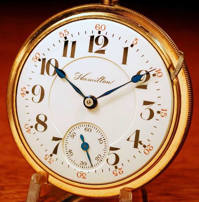

My 940 deserved better than what was on it, and with my heathen Amish watchmaker being stacked up, I thought I'd try it solo.
How'd I do?
April 19, 2011, 20:54
Mike HodgeWow, great job! Did you use a solution, or heat?
April 19, 2011, 21:25
Mike LaForestLooks too perfect - especially for a first try. Unless you tell eggsactly what you did, I won't believe you did it.
April 19, 2011, 21:29
Edward L. Parsons, Jr.Outstanding job of bluing Eric! You also need to get a proper "spade" seconds hand, something like this.
April 19, 2011, 22:10
Eric UnseltAncient Chinese Secret, Mike.

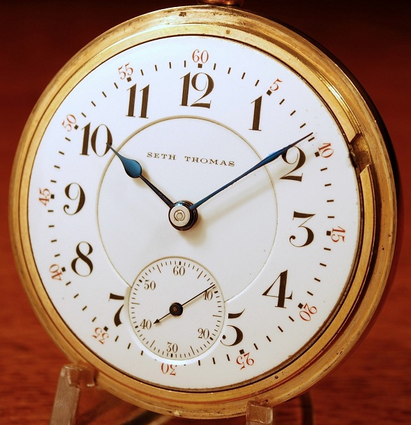

It's idiotically simple - some 12,000-grit emery cloth made by 3M and careful supervision over a small oil lamp. Don't forget to buff out the minute hand hub when you're done with the heat.
Ed, I put the seconds hand back on my Bunn after I blued those too.
April 19, 2011, 22:30
Eugene BuffardGreat Job Did you put them in a brass pan to keep the heat even. I guess I'll need to try a few.
April 20, 2011, 01:03
Robert Lee MillironUnbelievable. Beautiful hands.
April 20, 2011, 01:33
William D. WhiteNicely done!
April 20, 2011, 03:02
Christopher DarwinThey're absolutely gorgeous, Eric. Would you mind explaining in more detail how you did it? I assume you used the 3M 12,000 grit emery cloth to polish the hands prior to heating them. How, exactly, did you heat them over the oil lamp? Did you use a pan or something to even out the heat and keep from burning the fine parts? I assume you came back with the 12,000 grit afterward to polish the hub.
I've toyed with the idea of bluing some of my hands for some time, so a step by step how-to would be much appreciated.
Thanks in advance.
April 20, 2011, 13:25
Jerry KingGreat job Eric....you should be proud and they really set both dials off....both are beautiful and really look great!
Everyone will want to send you their watch hands now for re-finishing....are you ready..?
April 20, 2011, 18:17
Eric UnseltPast results do not guarantee future outcomes, so bring 'em on, Jerry.
Christopher, you'll have to experiment with heat sources and transference media. My first effort was holding the hand directly over the gas flame on the kitchen stove - too hot, too fast. I tried copper plate, steel wool, and a bed of brass filings in a warming pan over different lamps, lanterns, and flames. The hands cannot be too pitted, or they'll never reflect the light properly. My best advice is thorough polishing, followed by slow heat with lots of babysitting.

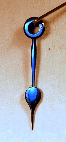

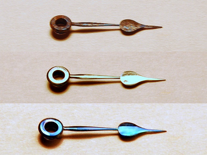

Eric UnseltHere is one of the worst hands I could find: a 16s Hamilton hour hand. It was fairly pitted, and I spent about 20 minutes sanding it by hand - no Dremel or buffing wheel.
The second frame shows a decent level of polishing. Admittedly, I could've spent more time, but this was just for a fast show-and-tell.
The final photo shows a usable hand that should pass muster on most watches. The lighting is pretty harsh - just a single filament bulb.
April 24, 2011, 22:29
Eric UnseltHere's that same hand stapled to a piece of shirt cardboard in the same setup that I would use to photograph watches.
Notice the color through the remaining pitting (which could be removed with further work). This was all done over an open flame.

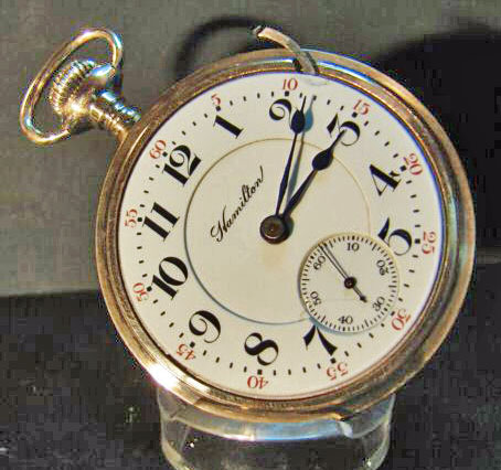

Edward KitnerI sent Eric a set of very rusty hands to see how they would turn out. Hamilton hands are hard to come by, so Eric's work on these is appreciated. A very nice job on a very sorry set of hands.
Thanks Eric!
Before:
May 02, 2011, 14:42
Edward KitnerAfter:
