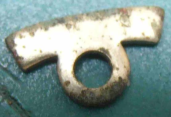

There are special spacer washers made for this problem. I have misplaced your address in the UK. If you need them I can send you a couple.

I guess I should clarify my earlier post. Yes, Lindell's suggestion is the right approach, BUT there are times where there there is little or no metal left on the edge of the case (almost always from those half-screws) and this is what the special washers are ideal for. This one obviously needs to be cleaned up.

If case rims are too far gone, you'll have to go the route Roger mentioned. Those "keepers" he has are the ones you want.

I have also had to use the ones that Roger is showing on the cases that have the hole Tom was talking about.

Absolutely agreed that the proper repair is to re-form the case as described, BUT if you have no alternative these spacers are better than just a thin round washer since they spread the load over a greater area of the edge of the case. I have never had a problem with the screws sitting up too high and hitting the case back but I can see how it could happen. The spacer washer I show is the proper fix for a case with little or no material left. They can also be thinned if necessary. These little spacer washers have saved a LOT of cases for me that have been damaged beyond repair.

Thank you once again Roger for sending me the washers, they arrived very quickly and should certainly do the trick.
