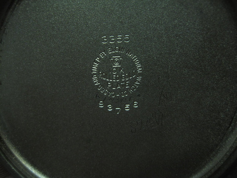

Here's one photo. They said based on date of manufacture of this and the case, no match up

Based on the research I've been doing I think the case it's in is from '50s so looks like I have my work cut out for me trying to remake it!!

Movement- 19J, Grade 455, circa 1920. It requires a mid to high pendant case with an antique style bow. Elgin RR "marked" cases debuted in 1923. This watch would have been cased by any of the case makers [generic].
Case "3355"- used from 1930's-1940's
Elgin Dial with Star symbol- 1933 to mid 1940's
