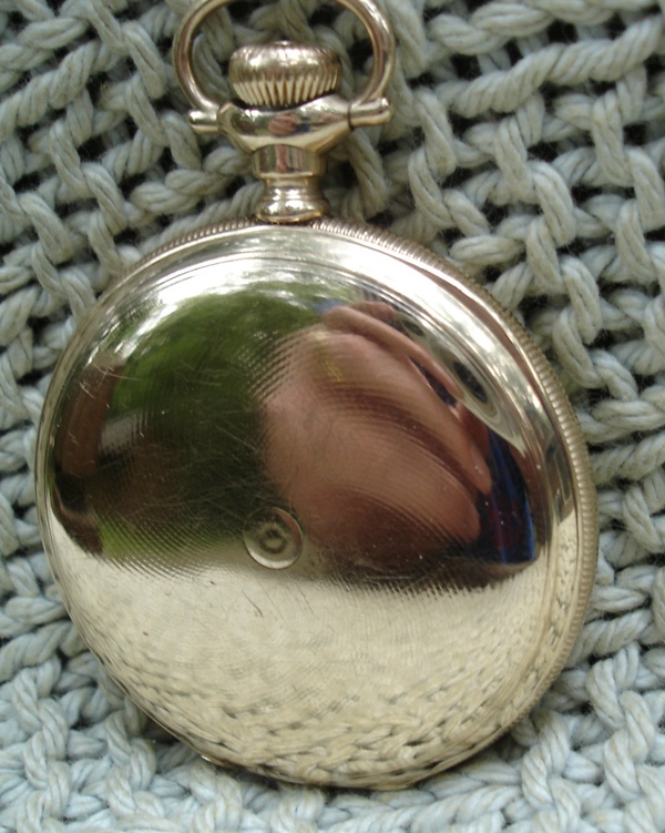

I recently aquired this 973 which is a positive pendant set, older model SN 335806. My question is regarding the 5 position adjust marking. My understanding is that they produced approx. 10,000 units of the 973, but, only around 3600 were marked 5 adjusts. I'll post this photo and someone will know for sure. This watch needs a good cleaning, but it does run pretty well now and I think it belongs in my collection next to the other two UNMARKED very early SNs. What say you?
December 04, 2012, 16:36
Hello Mike,
The watch you are asking about number 335806 is a Grade 973 shown on the Gelson List as from 1905-1907 production. Your Grade 973 is the Hunter version of the 972 movement. All of the 972 and 973 are Railroad Grade 5-Position movements, but beginning in 1906 many Railroads no longer approved Pendant Set to enter Time Service and Hunters were being frowned on. In that same 1906 time-frame Grade Markings were becoming a requirement as well hence the marking you find on this one but not on your earlier examples.
By the way, according to Hamilton records there were approximately 6,000 total Pendant-Set versions of the 973 and about 3,600 of Lever-Set 973 movements produced. In my opinion this is an example would fit neatly into your collection and therefore is very much worthy of preservation.

Thanks to both Lin and Deacon. I now see the 973 is still in the "single roller" configuration. I do like the marking and will clean and keep-for a while. Deacon, I too enjoy and then sell, so I can buy! The bulk of my watches are in my bank in Oregon so I have few here to enjoy. I really asked the question as to keeping with my wife's tongue in my cheek!

Nice 973, Mike.Is that a detent-stem ? I see an arrow near an extra hole by the crown wheel, never seen that before....Regards, Ted.
September 20, 2013, 01:14
Mike Hodge
Yes, Ted. It is a detent, or positive pendant set, mechanism.
