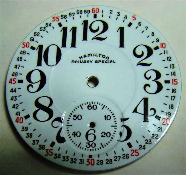

Let me reword my question: The Melamine #379 RWS dial has the #5 and the #7 partly clipped off and the LaRose replacement dial also has the #5 and #7 clipped off. The new collector (not knowing about the LaRose dial or how to indenify it) could buy a watch with this LaRosa replacement dial thinking it is a orginial 379 Melamine RWS dial.
My question : Below is a picture from a post by President Riddle, having the #537 dial.
Does the #537 Blind Man Numerical RWS Porcelain Dial (like in the picture below) have a LaRose replacement dial that has the full number 5 and 7 that looks like this original? Confused

If this is the dial below you're asking about, there should be a few indicators.
1.) The 0 on the 10 goes onto the center area, where on an original it would be cut off due to the double sunk.
2.) The tails on the 3 & 9 are thick on the original and thin on this replacement.
3.) The minute markers on the original are thicker versus the replacement.
I'm unsure if these are common indicators for other replacements, but it would be for this one. You will also note that the replacement has a poor double sunk effect versus the original.

Jared, I think the picture with your post is a replacement dial for the orginial #379 Melamine Dial (clipped 5 and 7). Does the Original #537 have a replacement dial with the full 5 and 7, like the original?

I did some research and came up with a photo of a fake Dial 537, similar to what Jared posted. I agree with Donnie, it looks more like a 379 than a 537.
I made a side-by-side comparison photo of this fake with a genuine 537 on the left and a genuine 379 on the right.

Ed, The center pic looks alot like the reproduction (of the #379) that Jared posted .
I have been watching a couple of watches with the #537 dials but I wasn't for sure about reproductions for that paticular dial. I haven't been able to find any info on counterfeit 537 dials probably for the simple reason they aren't any.
