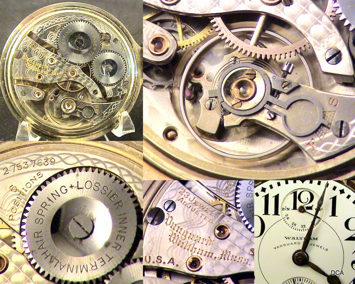

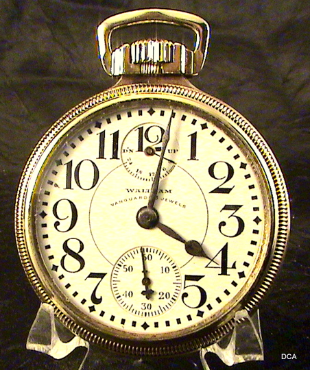

I had the honor of restoring a 23J Vanguard Deacon sent me . . .
March 09, 2013, 19:34

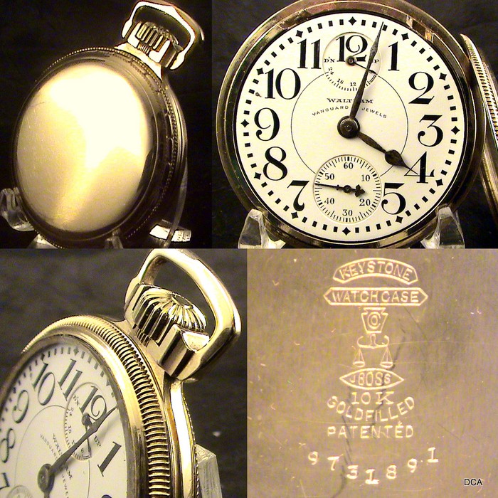

Which was constructed in 1932 . . . s/n 27537639
March 09, 2013, 19:35
and nicely cased AND . . .
March 09, 2013, 19:46
FITTED WITH A ONE OF A KIND WALTHAM ALLOYED ELINVAR UNCUT BALANCE WHEEL AND HAIRSPRING! used in the R&D conducted by Arthur Rove in 1933 to sucessfully complete his refinement of Waltham's most accurate Elinvar-based movements!
This is a "ONE OF A KIND" watch.
A friend in the Waltham, MA area is forwarding the Data cards from this testing that I will return to our very own Deacon Jones with this excellent running watch next week.
Congratulations Deacon for your part in rescuing this piece of history!

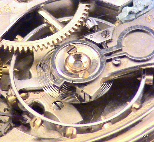

Note the little green thing in upper RH Corner is a piece of Rodico I used to stop the balance wheel for the Photo)

Dave in the 4th photo you might want to use the piece of rodico to grab that hair or fuzz at 6 o'clock position.
Wonderful job.
March 12, 2013, 00:29
The fuzz left w the rodico. Since the watch refused to budge even one second over 72 hours, I put it in the fridge this AM, see how it likes the "COLD"! Frown

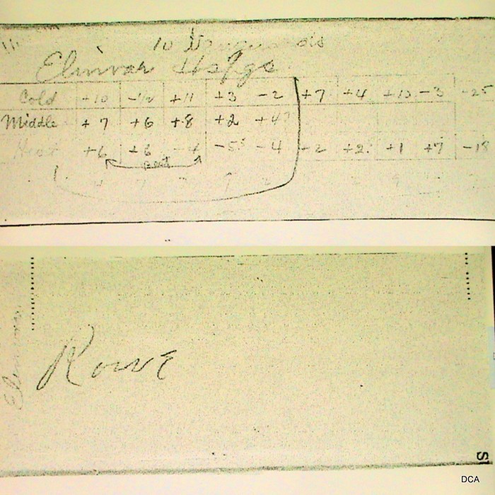

This is the "Rove Data card" I think this one is number 4 (counting from left)
Note the top of the timing strip says "10 Vanguards".
In some further discussion with my friend from that area, he said one of his ex-Waltham friends told him that Waltham called their material
"Elinvar" and were making at least some of it themselves . . . probably under license from Hamilton. That was mentioned because Waltham did experience continuing difficulties with alloying this stuff.
