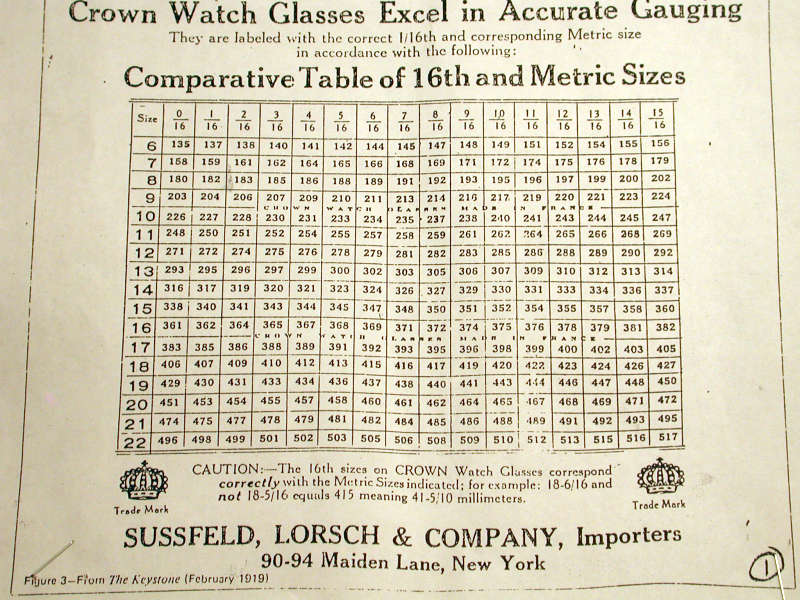

Mike Hodge
One interpretation is that the Ligne is the whole number and the fractional number is a portion of (I believe) a ligne. If you multiply the whole number ligne by 2.25583 you get a metric (mm) equivalent. Then, multiply the numerator (top number) of the /16 fraction by 0.141. Then add the two numbers to get a metric size crystal. Some crystals have the metric measurement listed under the Ligne number, ie 424 is 42.4 mm but as you can see the decimal is omitted.

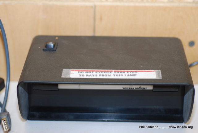

Phillip Sanchez
Jim, I have a little u/v lamp. Works great.

Roland Glenn
Here's a crystal size chart found easily on the web showing the conversion between Ligne and metric.
I too have used the UV glue with great results even in winter with bezel placed on a window sill indoors.

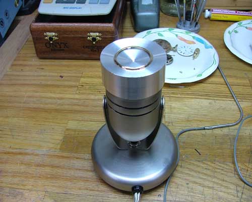

Paul Arsenault
I have made a bezel warmer. Purchased a halogen light from Home Depot for $39.00 and turned a piece of aluminum to fit over the top. I measured the temp with a digital candy thermometer. The high range of the therm is 322 degrees. The temp of the aluminum went past the high range. Have only used it once and it was very easy. Need to be careful when removing the bezel. It's HOT.
March 06, 2011, 18:14
Phillip Sanchez
Neat looking, Paul, You do good work for an old guy. Big Grin

Dr. Debbie Irvine
Here is a printable chart on site...
CLICK:
Ligne Conversion Chart for Glass Crystals
