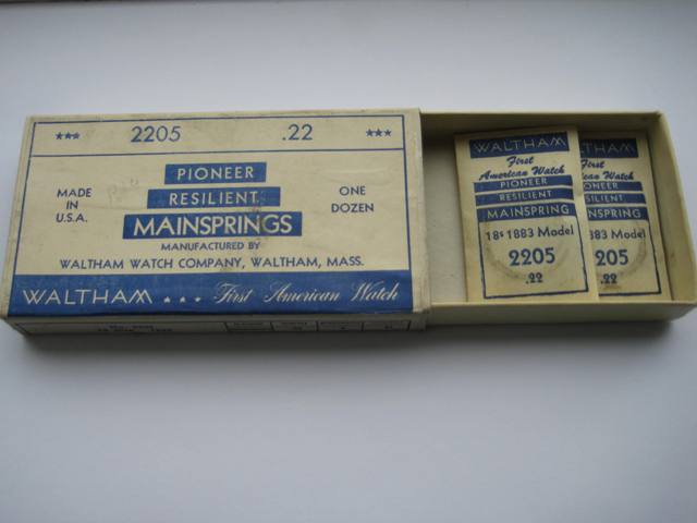

I`m beginning to think that mainsprings do not store very well. I`ve tried to replace one in a Waltham 83 Crescent St. movement. Up to the present, 4 springs have snapped when applying some winding power & I`m tempted to bin the remaining 2 I have left & buy some "new" unbreakable ones. Any thoughts ?

Mainsprings have a "life of their own". The Waltham factory replacement springs you pictured should be OK unless they are rusted. One thing . . . they WILL BREAK if you install and (try to) use them WITHOUT CLEANING!
Many of these springs were coated with a preservative stuff that becomes quite sticky and will force a break unless it is cleaned off.

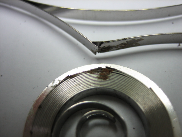

This is the nasty surprise I got some time ago from some swiss made mainsprings bought on ebay, obviously stored in less than ideal conditions.
June 21, 2012, 13:33
The spring Peter shows is an excellent example. If you insist on popping those out of the retaining ring (they explode) . . . wear saftey Glasses
