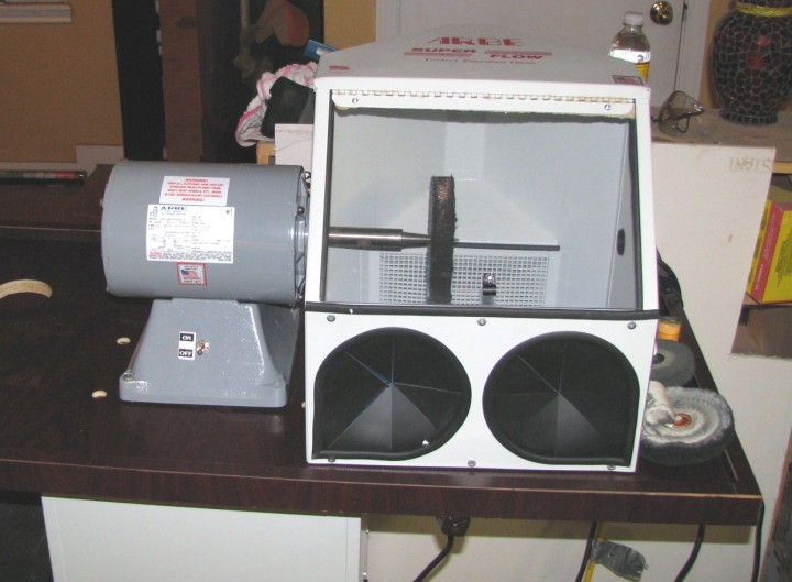

The Dremel are not bad but due to the low power and thin buffs can leave lines, also throws dust and residue all around the room with time if using rouge you will notice it getting all over the room you buff in plus in hailed, always use a mask & glasses with dremel. I use (chance to show off a recent new toy) a fully enclosed buffing machine with full extraction & filtration, no dust dirt or flying object are getting out of this so can relax when doing it, it uses a ¾ hp motor the power & 8” buff leaves a near perfect smooth finish. The Mass paste is good but will leave scratches.

I very rarly use anything but the buffing machine, I have a clean room, wet & buffing polishing room they say this new machine of mine catches all the dust and could be used in the clean room so far I think you could!.

Your correct in many ways the machine I have is only viable to for professional use due to the high cost, I expect this setup will see me out. I was very much in two minds to invest in a complete system or to modify my current setup which dust was escaping from (the open extracted cowls do not work adequately ), after much deliberation I decided to invest in the ready made system and move on problem solved, and of course company owned tool after all its just another machine in the shop. I cannot say how much better the entire setup is to other systems I have used the extraction on this machine is exceptional far stronger than could be obtained form a shop vac and once extracted is filtered through various filters (hepa also) so nothing gets out motor power is huge no slowing it down while polishing.
As you say it would be relatively easy to construct a cowl or box with Perspex mounted on a table top hooked up direct to a shop vac or complete shop vac system and would work very well indeed for occasional use, working by a shop vac nozzle would be good idea for dremels.
I would just like to add again at the risk of sounding boring but cannot stress enough these bench polishers should have a extraction or use good filter mask & glasses (even dremels over a relatively time), you don’t realize how much comes off that your breath in, and only take a short time for the dust to get everywhere rouge is terrible once in dust form to clean up. I know from experience on the bench buffers, when things go wrong it happens fast, to fast to respond, if you present a part to the wheel wrong or it catches, it will tear it from your hand even S18 coin cases and fire off at a truly amazing velocity, given the fact you are stood directly inline a head shot could very easily cause serious injury.
