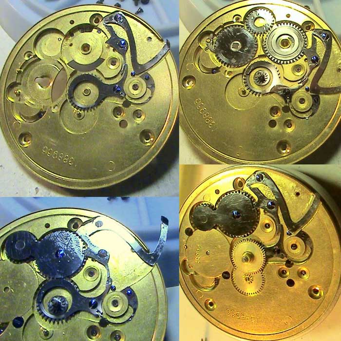

April 20, 2013, 21:23
Greg, I totally agree with Buster. I was referring to the HUMONGOUS number of parts some watches used in setting mechanisms which dO from time to time have reverse backlash meaning the hands would have to "wait" a few minutes for the wheels and gears to catch up to them after setting. This Elgin is a prime example . . . even though it ends up liking to be set clockwise anyway . . .
