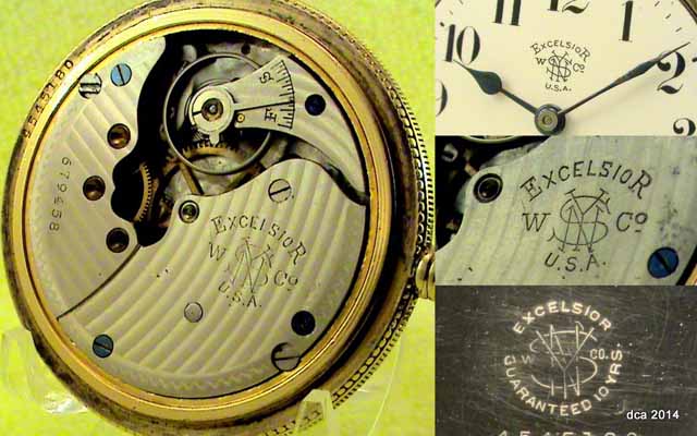

This New York Std. triple signed 16s Excelsior passed through my collection recently. It is a 16s. There were several watch Companies that used that name, but a picture showing the "New Bedford" on yours may help identify it better.

Thanks David That is a beautiful watch.Peter i thought we might have met somewhere. i lived in Prescott valley yrs ago.

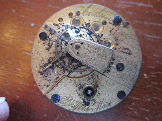

here is a pic

Wayne, you have a "Swiss copy" (fake) of the 1857 Waltham. The giveaway are the false jewel screws for the train jewels.

ok thanks David. I found that in a bunch of stuff that i bought from a retired watch maker. Thanks again Wayne

As Paul said, good condition examples of these are restorable. The surprising part of these is that many were actually hand-made movements with varying degrees of skill. On some, after disassembly, you can still see the layout compass scribe lines on the plates that defined the train pivot hole positions. The train jewels themselves are pressed in to the plates and the things that look like jewel mounts are contoured countersink shapes plunge-cut into the plates. Hence the dummy Jewel Screws are positioned at the edge of those details with no actual intersection to the fake contoured jewel mounts.

Dave, It sure sounds like it would have been the same work to use real settings.

Paul,David and George I will prolly disassemble the moment to to inspect and see what it would take.I have several 57 movement to compare with.
