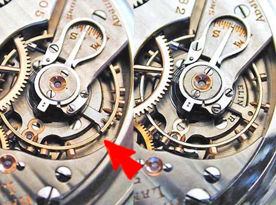

Samie's right Bruce, and then of course carefully check the balance wheel. It should look like the one on the right in this merged image below. You should also find "ELINVAR" marking on the pallet bridge. And if you still have doubts I suppose you could also try exposing it to a magnetic field. Big Grin
On left at the arrow is a non-Elinvar split balance...

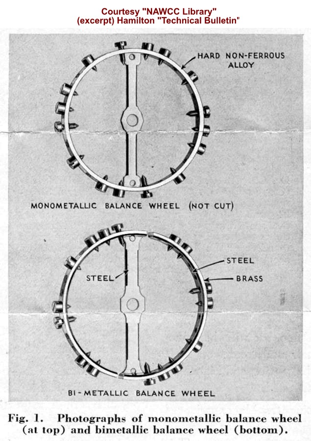

Below is an excerpt from a Hamilton "Tech. Bulletin" showing the pre-Elinvar balance wheel (monmetallic) at top and the Elinvar bi-metallic (brass & steel) split balance wheel at bottom.
Hope this is helpful.
