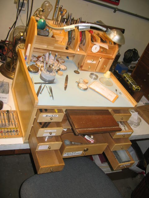

Buster BeckIf one is ruining a screwdriver tip, generally the wrong size is being used. Make sure the screwdriver fits into the slot of the screw and there is no wiggle room.
Watchmaker screwdriver sets can be found on the bay from $550. to $25. If one has a bench/workstation, I would recommend a set in a revolving stand with extra blades in the center black slot. A cheaper set will last the hobbyist many years. I have only one set bought 30 years ago as described above that I paid $40. for, and it will outlast me. The sizes on mine run from .60 to 3.00 and there are 9 different.
