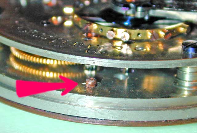

I agree with both Brian and Tom, you likely have a "pinned dial" with little brass taper-pins as shown in the image below of a Springfield Hampden Railway number 425380 from around 1885 or so production. Unless someone has substituted a later dial the holes are there, they are very, very small.
These pins are identical to those used in clocks and they are readily available within the trade.
They used a taper-pin used to secure the dial...

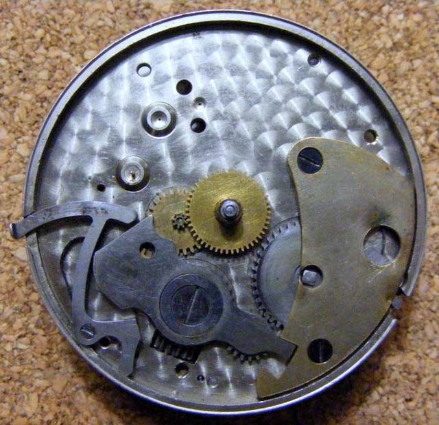

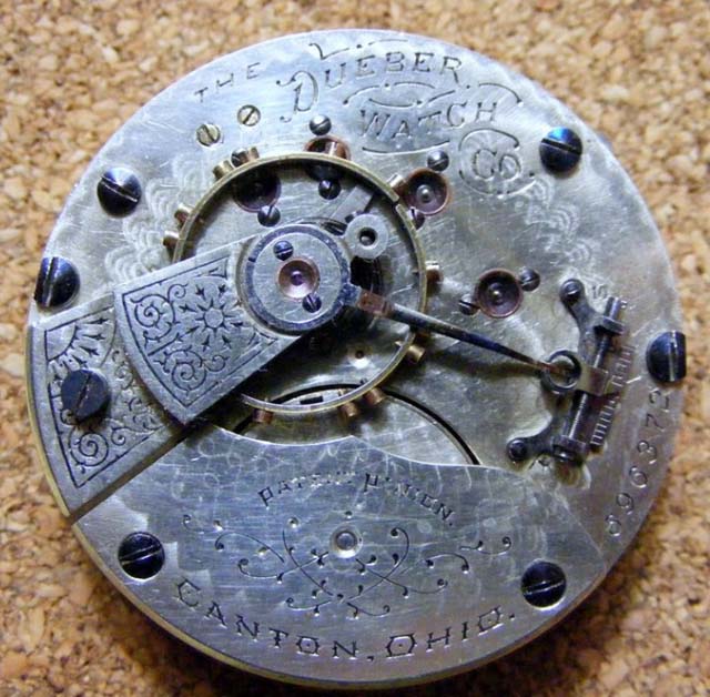

Some pictures
September 08, 2010, 11:47
Claude Griffith
Next Picture and after looking at this one I tend to think it is an 11J movement since it does not have any jewels on the pillar plate but has 4 jewels visible.

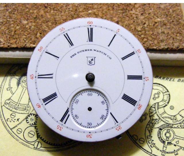

Dial and I will check tonight for some pin holes

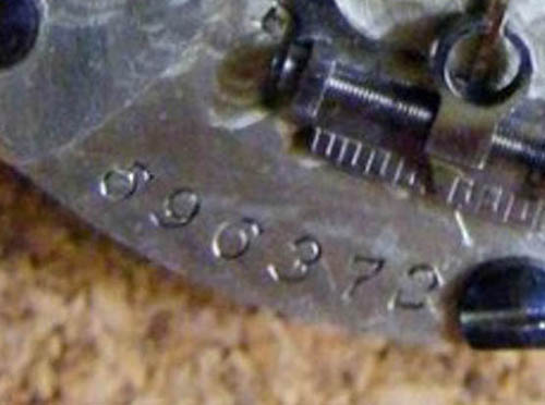

Claude, take a look at my taper-pin image, that's what you are looking for. Below, a closer image of your movement number perhaps 596372 but cannot be certain of that first (maybe 5 or 6 ???) digit. Lindell Wink

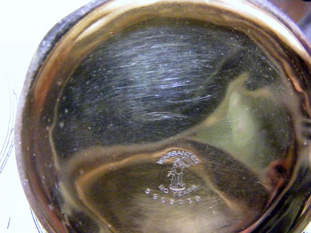

I checked the original listing on ebay and it was listed as 696372 so it appears the shadow is blurring it a bit so that it looks like a 5 instead of a 6. I checked the dial after I got home, the post at the 14 min marker is not pinned but has a notch facing out. The post at the 52 min marker has a hole for a pin, the post at the 36 1/2 min position is missing but I would think it had a hole for a pin. When the dial is installed on the movement at the 14 min position on the movement there is a machined hole so there much have been a pin of some type that was inserted into the hole that locked the notched pin. If someone has a trashed Hampden/Deuber dial that still has a post with a pin hole leave me a PM. I also have another question, if you look at the brass plate that has the lever set notch, my impression is that the plate should be flat, if you look at mine it has a ding at the larger hole and another ding near the notch in the pillar plate. Are these dings just a bad repair in the past or was it designed to be that way? What company had this marking for it's gold filled cases?

I have an old A.E. Rogers watch Scranton P.A. it has a Duebers Watch Case 3 door Hunter style. A nice watch but the case has a spring broken on the back cover hinge. Is it repairable do you think? I could get it out of the box and take photos of it.
September 15, 2010, 08:12
Claude
The symbol on your case back was used by the Dueber Watch Case Mfg. Co.

Claude, a couple remarks,
1. That dial you have is in excellet condition. Use it.
2. The "dings" in the click wheel cover plate appear to be added to retain more securely the click tension spring and also to retain the click itself so that they did not prematurely release the click wheel and suddenly unload a full mainspring wind to the movement.
