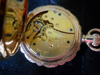

Don't know about value, but I think the parts could be found. Here's what I found about the movement.
Start 1/1/1894 End: 12/31/1895
First: 6596001 Last: 6602000
Model: 1891 Name: No. 60
Material: U Grade: Seaside, NL
Plate:
Jewelling: 7
Balance: Ex.
Style: HC

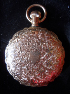

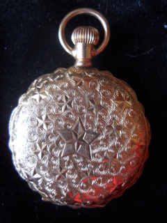

Front
May 22, 2012, 19:36
Brad Richardson
Back

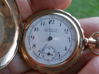

Face

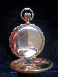

Cuvette

Movement

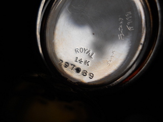

I am trying to decipher whether this case is solid gold or not. I am also wanting to know more about this particular manufacturer...Royal. Any info would be appreciated
Markings

Brad, The bezel is the tough part to fixing this up. I would try to find an O size case from the same maker and use that bezel. The problem is that I am unfamiliar with the Royal case mark so if someone knows who made the case that would be a great help. Even gold filled would work. It also seems to me that the case may not actually be 14k solid gold. In the past some con artist might have tried to pass that off as a Roy 14 k case as they were well known for their 14k cases, so start with finding the maker. Happy hunting.

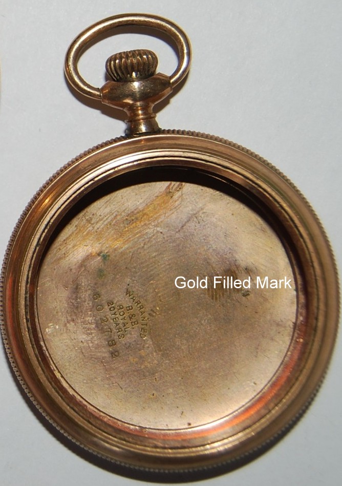

Deacon & Brad....The Royal case is made by Bates & Bacon, commonly known as B&B....

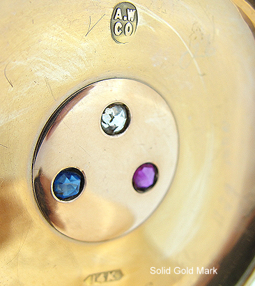

If the case in question was solid gold I would expect the hallmark to look similar to the photo below....It does not, so I think it may be suspect in that regard....
Of course Brad, you can always give it the LR (Lindell Riddle) Flex Test....
May 23, 2012, 14:39
Jerry King
This is the Gold Filled hallmark....
May 23, 2012, 15:09
Brad,
I agree with Jerry, the "Royal" Trade-Mark was owned by B&B and for many years was used on their 20-Year Gold-Filled Cases. Looking up an IHC Find-Or-Search for B&B Royal brings up numerous postings about such cases. There is also information on page 64 of the Ehrhardt Trade-Mark Book where "Royal, B&B, 20-Years" is shown. Usually a Trade-Mark is used only by one company or its successors such as we find in this instance which along with experience leads to the logical conclusion this one is quite likely a Gold-Filled case.
Also, during the 1880s time-period of this particular watch the use of a case model name and "14 K" was presumed in the trade to mean 14K Gold-Filled Case, later the length of guarantee was added as in Jerry's picture and finally beginning in the 1920s actual content had to be stated on jewelry items including watch cases.
The "flex-test" that Jerry referenced is one I have long advocated to help in learning how to recognize case-content, once you handle enough cases it will be almost second-nature to recognize what you are holding.

Thank you Lin and Jerry. This helps immensely. Of course, I get to tell my aunt that $250.00 was just about right. Roll Eyes However, it might be a whole lot easier to find a complete case than a bezel to fit this one. Regards, Brad

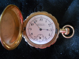

Well folks, she's done! Just got her back from Chris! Looks like it was made yesterday!!! I want to heartily thank Leon Harris for the fantastic job he did with fitting a bezel and crystal; Gary Cochran for the new seconds hand; and of course, Chris Abell for the complete COA. My wife's aunt will be tickled pink! Smile
