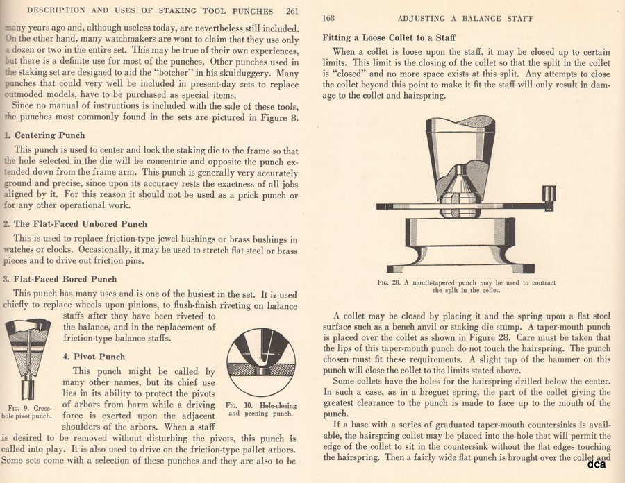

There seems to be so many ways to "skin a cat". When the Hands are just slightly loose I stick with adjusting the hands because they are more replaceable than Cannon Pinions and Hour Wheels, etc. Here is what I always do; (STUDY H.B. Fried's page cc's)
1. Slightly Loose Minute hand;
Using a "Peening" (round tip) punch with tip diameter about 1-1/2 times the minute hand hole size, place the hand "face down" on a large flat stump in staking tool, then bring the rounded head punch to center on the minute hand hole and give it a light smack with a 1-1/2 to 2 ounce brass jeweler's hammer. Test fitment, and re-smack until it presses on.
2. Slightly Loose Hour hand;
Using a "Mouth Tapered" (inverted taper) stake with tip diameter larger than but not more than 1-1/2 times the hour hand collar size, place the hand "face down" on with a large flat stump in staking tool, then bring the Tapered stake to center on the hour hand collar and give it a light smack with a 1-1/2 to 2 ounce brass jeweler's hammer. Test fitment, and re-smack until it presses on.
3. Loose Minute Hands, Slide the second hand on to a micro-broach (often the one I used to open up the second hand hole in the first place), back it up slightly towards the smaller tapered end. With a Jeweler’s pliers squeeze it slightly and re-try fitment. Be VERY CAREFUL not to force the second hand on to the 4Th wheel arbor, you WILL BREAK the arbor. BIIIG POBLEM!
NOTE, as shown in the picture, method 2 can tighten Hairspring collets, and I use Method 1 to tighten Balance wheel Staff holes so they remain well enough centered to lightly press fit to the staff so that I can still easily Poise them
