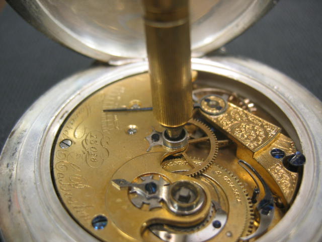

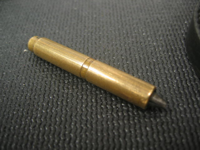

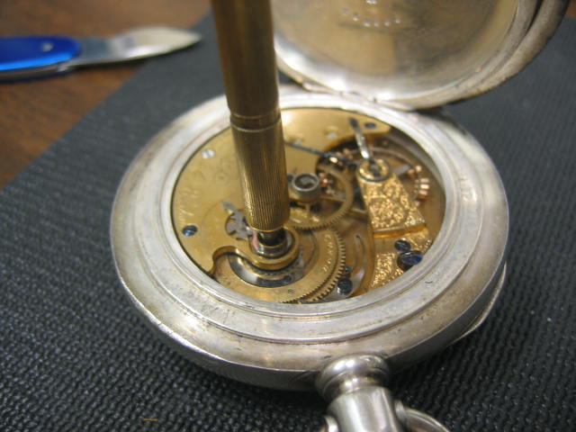

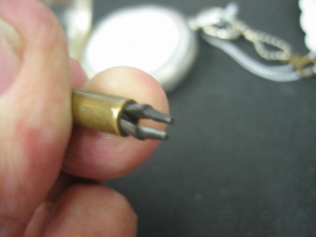

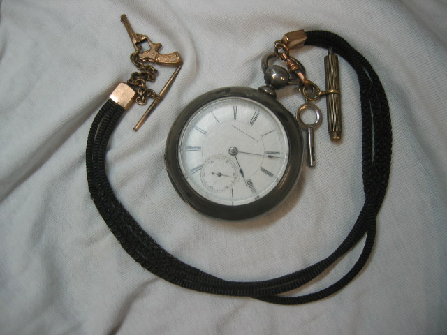

An old gambler's watch which I have (I really wish it could talk!) came with a most useful tool which I will illustrate (That is a human hair fob rope thingy)
September 28, 2007, 22:50
The tool itself (same but different tool than the gambler's watch set)
September 28, 2007, 22:52
How it works
September 28, 2007, 22:53
In use
September 28, 2007, 22:54
The tempered steel "jaws" with a steel cross-torque control pin make this an extremely versatile tool, so I have taken this to design and am planning to produce 500 PC's for general sale.
