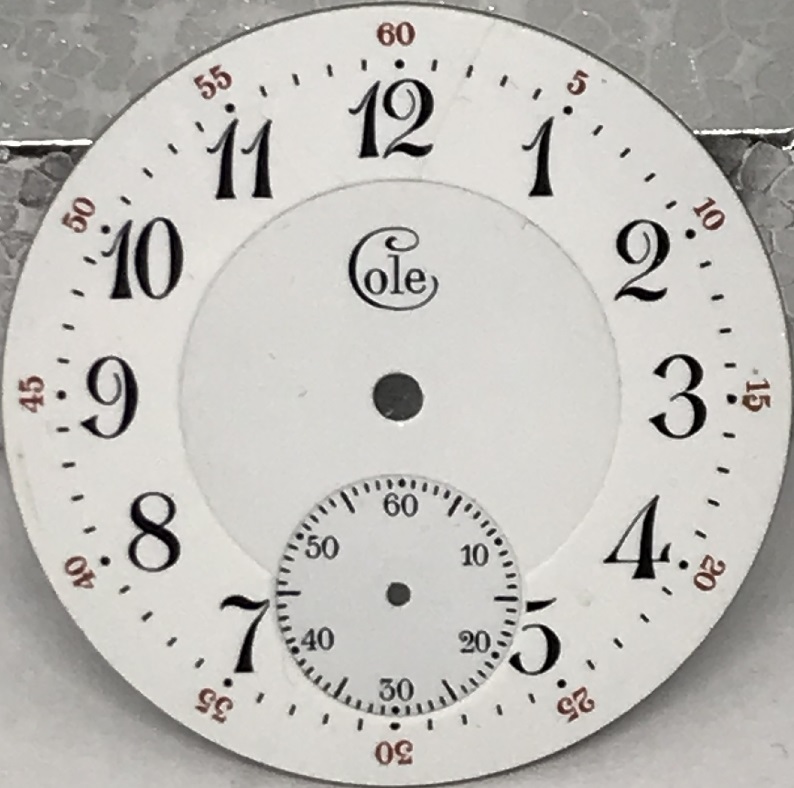

What movement would this 16s dial be correct for?
Hello all
just wondering what movement this dial would be correct for? I bought a Rockford 16s sn= 783521 hunter movement and this dial was on it.
If anyone knows the proper type of movement it should be on please let me know.

If the dial feet are still on the dial and match up for the Rockford then I would say it is a private label for Rockford. The 3, 4 and 9 look like dials found on the 566, it looks to be a nice DS dial in good condition, I would just clean it and install it back on the movement.

Claude thanks for the advice and yes the dial feet are still on it.
