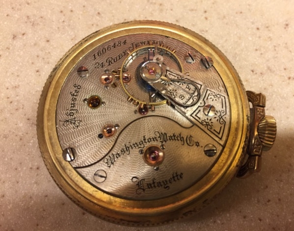

I inherited this watch in 1993 and placed it in a safety deposit box until recently.  I have done some research on it but would like to know more if some on this board has information.  Thanks in advance.
August 10, 2016, 20:20
Gary E. CochranVery nice 18 sz. high grade railroad grade pocket watch made by Illinois Watch Company about 1902...This is an uncommon or kind of rare watch with only about 2500 produced...
August 10, 2016, 21:55
Buster BeckThis is an early Model 6 and should be a 'single roller' as opposed to a 'double roller' which was a bit later. They were a Bunn Special Grade, under a private label- The Washington Watch Co. which was sold by Montgomery Ward & Co by mail order.
 We believe only 310 of these were made in the 'single roller' configuration. They should have a marked Washington Watch Co. double sunk porcelain dial with Arabic numerals. Many of the later ones are found in a M.W.&Co. marked case also.
 Extremely scarce to find one today in any condition. A 'centerpiece' of any worthwhile Illinois collection to say the least. The gold plated or gold filled case is from a later era than what the watch would have originally came in.

Bila WirriganwaltersHi Mike,
Gary is correct with regard to this being a high grade watch. To further expand on what Gary has said approximately 1,620 units where produced with the "Lafayette" marking, this total included both 18s 24 jewel versions and the 16s 23 Jewel version watches.
Of the 18 size versions there were two Grades marked as "Lafayette" the Grade 79 (a very small production of only open face watches) and the Bunn Special grades in both open face & hunter versions.
Total production of 18 Size Lafayette's was only 980 units (approximate), of these the 18s 24 Jewel Bunn Special open face version made up only 720 units (approximate).
So to summarise, a very nice hard to find watch which is now probably bordering on scarce if not rare and usually bring a premium price in my opinion, dependent on condition of course.

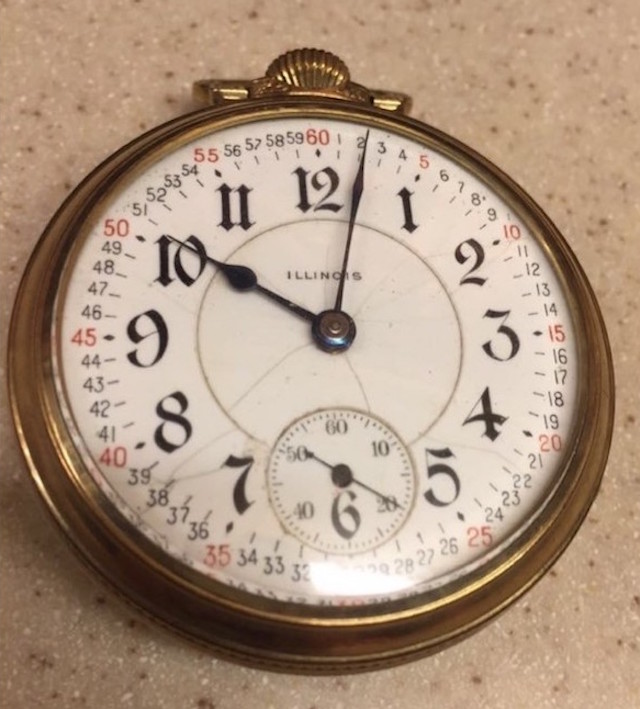

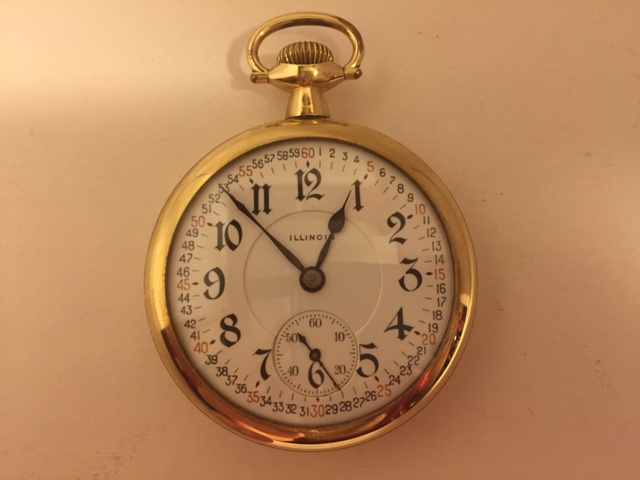

Mike KachurakThanks all for the information.  I had issues trying to minimize the picture of the front of the watch.  I think I got it now so here it is.
August 11, 2016, 01:11
Bila WirriganwaltersDefinitely the wrong dial Mike.
August 11, 2016, 07:53
Mike KachurakBila - What do you mean by "wrong dial".
August 11, 2016, 08:10
Bila WirriganwaltersAs Buster said in his early post Mike should have a "Washington Watch Co" dial to be correct.
Looks like someone at some time in the past has fitted an Illinois dial from a later era watch.
The font is not correct even for a Bunn Special of this age and time, it should have fancy Gothic script font.
August 11, 2016, 08:22
Mike KachurakYes I see that in Busters post now.  Missed it on the first read.  Bummer.  My good watch now is not so good.
August 11, 2016, 08:33
Bila WirriganwaltersDon't be disheartened Mike, still a very nice watch, if you keep a look out on that great big auction site you might find a dial and correct case.

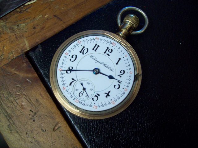

Roger StephensHi Mike, I will post a picture of the Washington Watch Co. Dial. This was in my collection,but has been sold. Your watch would have a double sunk dial whereas this is a single sunk dial. The font would still be the same form. Hope this helps in your search.
Roger

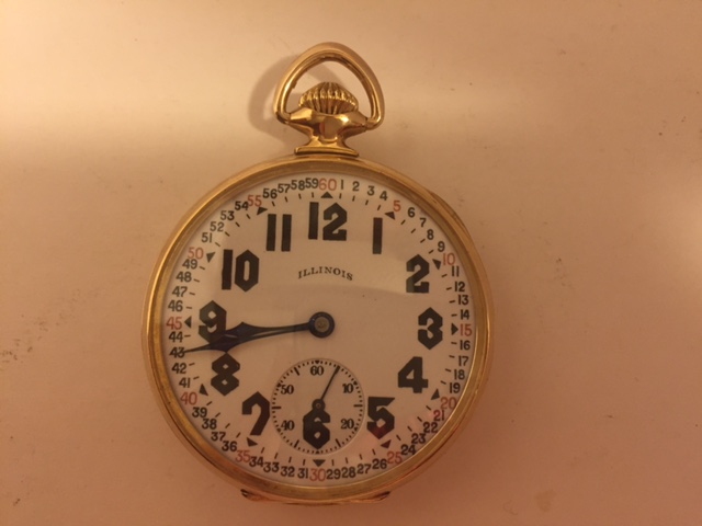

Michael P. McNameeMike, as a matter of interest, here is a dial similar to yours on a 16-size, ca. 1912 Illinois "A. Lincoln" . . .
August 11, 2016, 22:36
Michael P. McNameeYour "gothic" Montgomery Illinois dial is one of my absolute favorites, after this later single-sunk "gothic"  Montgomery dial on a ca. 1922-23 Model 10 Illinois "Sangamo Special":

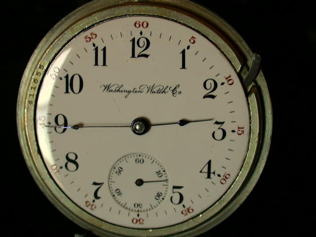

Bila WirriganwaltersHere is a double sunk dial & long pendant case  that would be correct for your watch Mike.

Bila WirriganwaltersThanks Michael it is a nice one, not perfect but good ones of these are hard to come by for some reason. Most you see are usually carrying a lot of damage.
August 12, 2016, 08:21
Mike KachurakBila - Thanks for the pic of the Washington Watch Co watch.  Studying the picture, it looks like they are exactly the same other than the name written on it.

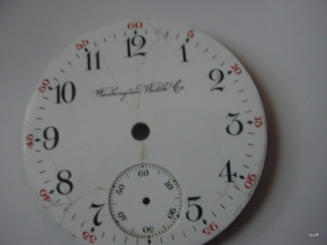

Kevin HoffmanI think I have a dial Mike ,I was kinda saving it, but , let me look . That watch is one I drool over
August 12, 2016, 14:43
Kevin HoffmanOkay , it is not as nice as what I thought , and I think it should be double sunk ,it might be worth a wait .

Mike KachurakKevin - Thanks for the photo but yes it is double sunk to be correct for the watch and era according to others here.  A little more info from me. As I stated at the beginning I inherited this watch in 1993 from my Father in Law.
