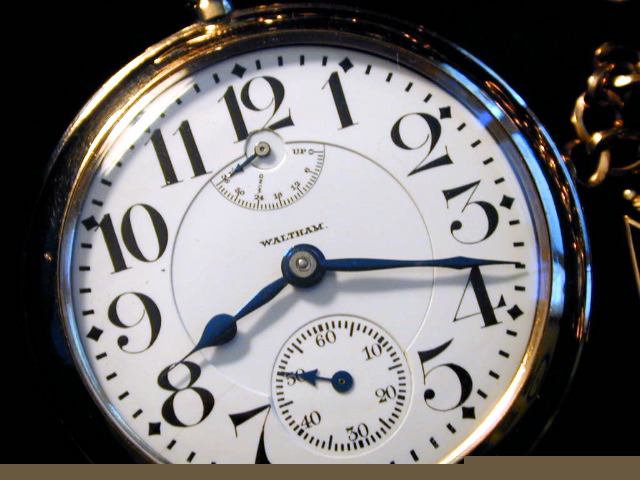

I can't help but think I would have wanted to carry a "Wind Indicator" were I around back then even given all the choices available. You see I like guages, meters, a lot of instrumentation. I guess I just want to be absolutely certain of exactly what is going on!
I'm not much of a "Waltham Collector" but this 23-jewel 1892 Vanguard WI is special to me...May 04, 2003, 17:52

Stephanie O'NeilLindell,
Thanks for your response and for the picture of your interesting and unusual Waltham. If only all our watches could have that feature!
