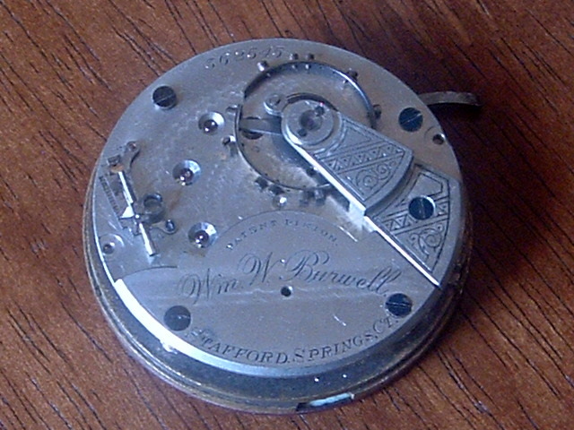

Do not know jewel count.Doesn't run.It is lever set.Missing regulator s/n 362545 marked Wm.W.Burwell Stafford Springs,Ct. Think it was made 1885. Any info would be appreciated.

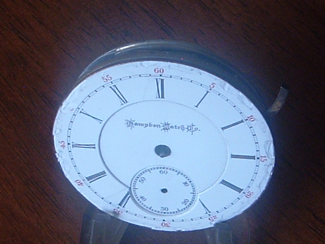

Dial

Roger Stephens
Movement
a
June 28, 2012, 19:36
Jon Hart
Roger
11j
Grade 57
1887 year made
Model 3
June 28, 2012, 19:55
Richard M. Jones
Hi Roger, Your watch has a rather scarce dial, sort of Gothic and it is a private label. Any other Hampden of that model will have the regulator arm and if I find a spare I can send you one. Actually if I find 2 since I have a movement with the same problem! Your watch would look nice in a Dueber silverine case if you have one. The build quality on your watch is reasonably good and the Teske regulator was used on thousands of Hampdens. If I can help a Hampden fan let me know.

Nice looking movement, looks like it's missing the mainspring barrel too

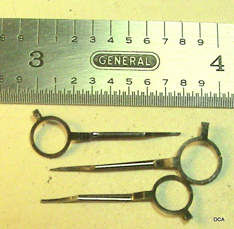

I have three Hampden regulator arms. Try to measure which one you need.
Deaconn which one do you need? Also I have your dial here still.

Hi David and Richard,Looks like 23.15mm from top to bottom.I think. Regards Roger

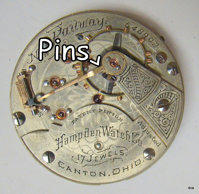

Actually, I think the regulator pins for your type MIGHT be in the arm body kinda like this New Railway I am restoring now. I have to look around some more.
If I am wrong (because your hairspring stud is waaay different) then the longer one should work on yours. I think you need a motor barrel too, and that suggests a V E R Y Close l@@k for anything else that might be misssing.
