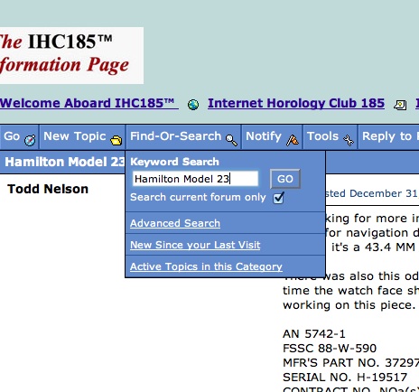

Whenever posting a watch please provide the serial number from the movement so it can always be found using the search function.
You can edit it into your first post by clicking on the little yellow eraser icon bottom right of the post.
Here is a screen shot of the search function, upper left of the page.
Just click on Find-Or-Search, type in what you are looking for then click GO.
