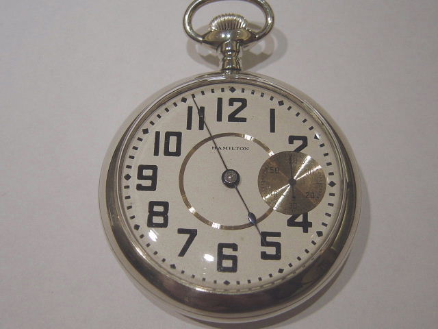

Leon HarrisHi Gary, Here is my conversion dial on my 925 Hamilton watch. I to thought it was very interesting.

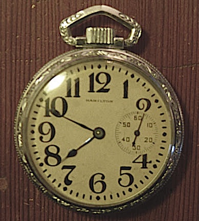

Norman BlissAnd my 16S non-RR grade Hamilton 975 (not quite so nice as Leon's).
Norman

Sheila GilbertVery nice examples you guys, Thanks!
Norman, I think your watch is wonderful. I like it.

Gary E. FosterHi Leon; The dial on your watch looks very much like the one on my brothers, yours is a bit cleaner though, a very nice piece. Thanks to all for the replies. Gary.
