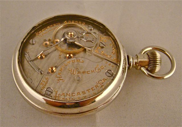

Here's a 942 (movement #459665) I recently purchased:

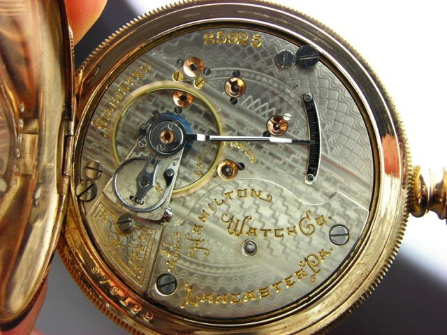

And here's the hunter version, Grade 943 (movement #85925):
April 07, 2013, 18:46
Theodore J. Brown Sr.
Thank you Ed, those are a work of art!Thanks for showing them.The damaskeening is similar to the motor barrel-marked 936 I have.I kind of figured the price difference would be in the finish.Regards, Ted.
