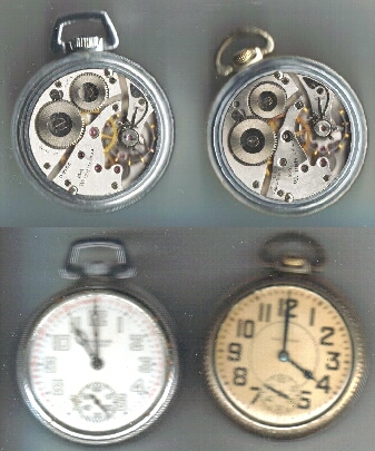

I have two model 16-As (see poor quality scan below). I think all examples of this model are American made. These are both 17j, pendant set. The only difference is the one on the left has "Adj.temp" with "3 pos." marked near the crown wheel like JerryT`S and the other has "5 adjustments" the dials are different and one has what I believe you call skeleton hands.
Shugart only lists the 17j 16-A model and a 22j model 16-A with 24 hr. dial.
And that`s all I know about that!

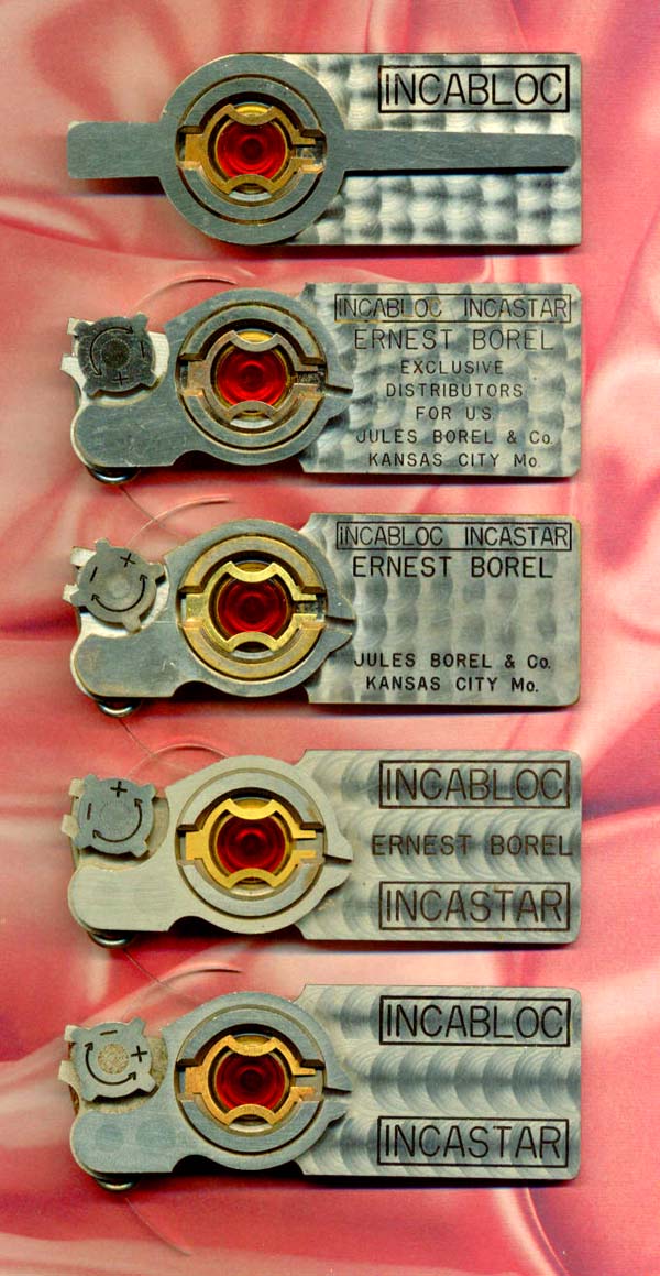

The regulator on the watch above is an Incabloc "Incastar," which was invented by Universal Escapement, LTD., of La Chaux-de-Fonds Switzerland, in the 1940s. At one time, Jules Borel & Co. of Kansas City Missouri was the exclusive US distributor, and over the years, I've accumulated what I believe to a complete collection of the various Incastar models offered by the company.
Essentially, the Incastar was designed to allow a "free sprung" hairspring to be regulated by means of a capstan roller, which rolled a portion of the hairspring in or out to regulate the rate. That was accomplished by means of a pair of "rollers," one of which was attached to the "star," by which it could be manually turned. Obviously, by shortening or lengthening the hairspring, the beat would be affected, and the entire device was made so that it could be rotated around the Incabloc assembly, in order to correctly adjust the beat.
Of the millions of watches that used the Incabloc shoch resist system, only a tiny portion of those incorporated the Incastar regulators. They seem to be most common on Borel watches from the 1940s and 50s, but I've occasionally seen them on Angelus, Doxa, and other somewhat "obscure" Swiss brands as well. The Waltham in the image above is the ONLY American watch I can recall seeing with one.
The image below shows five different Incabloc demonstrator models, in descending order from oldest to newest. The one at the top is a standard Incabloc model, while the four below are different variations of the Incastar models. If anyone happens to notice any other Incabloc models on eBay, or anywhere else, I'd appreciate it if they'd call them to my attention.

Stu GoldsteinSteve, you’ve posted info of interest to me so many times; it pleases me to have (serendipitously!) posted something (the Incastar) that interests you.
I’ve never seen regulators like the ones in the two movements above the Incastar. I hope you or someone can tell me: are they "micrometric" regulators? how would the user operate them?
Thanks a lot as always!

Maybe I'm missing something, but the regulators on the watches you posted on 11-17-2003, at 6:06, appear to be simple "index" regulators, which are the most basic types made. To adjust the rate using such a regulator, the "tail" thereof is moved with any convenient implement (a toothpick, for example), and the scale beneath shows the relative degree of change. They are "simple" regulators, not "micrometric" ones.
Am I confused about the question you're asking?

If you are referring to the two 16-A`s I posted, they are both micrometric like a normal whiplash regulator with adjusting screw. Only the spring is a half-whiplash.

Kenny DraftsThe serial numbers on the two 16-As that I have posted above are "32031949" (left pic) and "32047627" (right pic). This would make them the 2,948th and 18,626th examples of the 16-A production according to the first serial stated in Jerry`s post. So we know that micrometric regulators were a feature through serial "32047627". Would be interesting if we could pin it down further.
