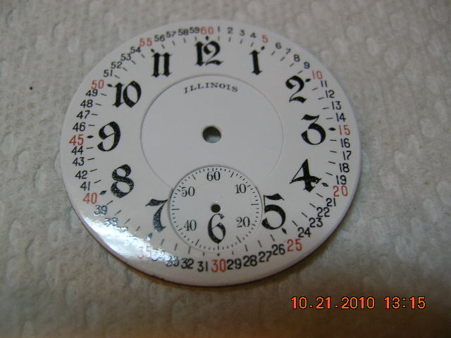

Larry LamphierIllinois Dial Question.
I was wondering if anyone can give me an idea of what kind of Illinois this Dial can go on?
Thanks for your help!!

Mike HodgeWhat size is it and where are the feet locations?  If it is a Getty the feet are located differently than others.  If it's a 17s, I would be interested.

Steve MiddlesworthModel 11 and 13 have the same feet position as the 6,7,9,10,14, 1nd 15. The model 11 is a 19 jewel Bunn with the motor barrel and Model 13 is the Sangamo Special with the 17 size dial but as we have seen in the past, people put 16 size dials on them and try to pass them off.
Also Model 10's were available with a 16 size dial and later movements came out with a 17 size dial.

Larry LamphierSorry it took so long.
17.5 - 39 - and 58 minute marks. 16 Size.
Thank you all for your help on this one!!

Steve MiddlesworthTaking from the EA diagrams in the Meggers book
18 SizeModel 1, 2, and 5-------------------------16.5, 36.5, 53
Model 3-----------------------------------1.5, 21.5, 38
Model 4 and 6-----------------------------2.0, 21.5, 38.5
16 Size Model 1, 2, and 3-------------------------8.5, 24.5, 45.0
Model 4 and 5----------------------------24.5, 36.5, 55.5
Model 6, 7, 9, 10, 11, 13, 14, and 15-----17.5, 39.0, 58.0

Larry LamphierThank you Steve.
Maybe I'll get it right now!
