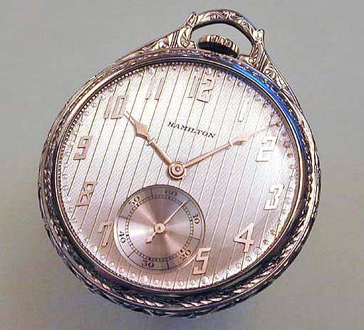

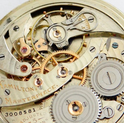

Jun Li
which one is the correct balance of hamilton 922MP
Movement Number 3008581
picture 1

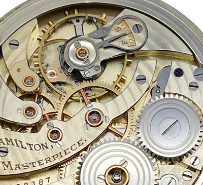

June 12, 2017, 10:19
Jun Li
another picture of 922MP balance

But after I searched the serial number. these two movements is produced before 1931.So it confused me.My question is which balance I listed is before 1931? because they have different cut. thanks

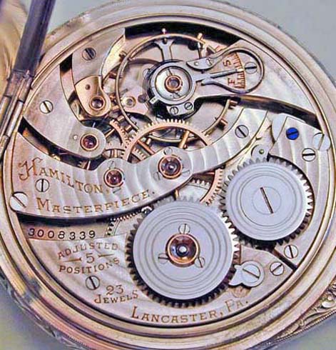

The Hamilton 12-size Masterpiece was regarded as Hamilton's Finest of Fine Watches even being available in Iridium Platinum Cases. (See first image below showing silver dial, gold hands and numerals and Platinum Case.) Buster's explanation of 922 vs. 922MP is spot-on, the latter IS considered a Hamilton Masterpiece (marked as such carries a premium in value) whereas the 922 was the more common grade right beneath it. Masterpiece movements were specially adjusted, timed as cased.
Your watches are BOTH considered as and they are MARKED as Hamilton Masterpiece movements.
First question...
Do you have any reason to think the balance has been changed on either watch?
And, do you believe something is wrong with one of the balance wheels, if so, why?

Hamilton Masterpiece 3008339 from my collection...
June 13, 2017, 02:50
This image may be of help.
Masterpiece 3008339 movement details...
