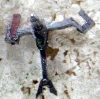

So far I have dug out one parts Columbus, it is also missing the regulator but I was wondering if the pallet fork could be used in yours.
I do not know much about Columbus watches, I thought perhaps you had the old pallet fork & you could tell if this one may work, you notice it is missing one jewel but other than being dirty the rest of it is fine.
I will see what else I can find, I know I have a couple of these here.
move
April 03, 2009, 19:37
One side of pallet fork
p01
Other side
p02
