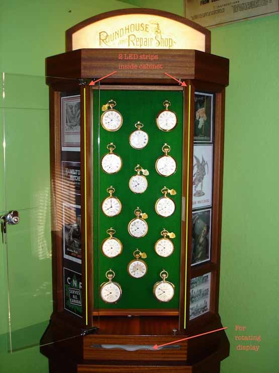

I was at the optometrist a few months ago and got to thinking about this Maui Jim sunglass display stand and how it could work for pocket watches.
One of the staff members contacted the Maui Jim rep and these stands were to be replaced with a newer model.
Intense negotiations ensued and a few weeks later I hauled this baby home in my truck. It is about 6 1/2 ft. high but the top lifts off so it was an easy job.
March 04, 2014, 10:30

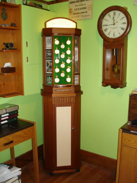

Lorne WasylishenThere was a great huge fluorescent tube down the centre and a smaller one to light the top.
Out they came and I ordered some 12V LED tape-on light strips from Lee Valley. All the rigging, transformer, switch, dimmer and wires are housed above the turntable.
Some 3/16 plywood, pool table cloth and cup hooks and she was ready to go.
14 watches a side, total capacity 56 watches.
March 04, 2014, 10:32

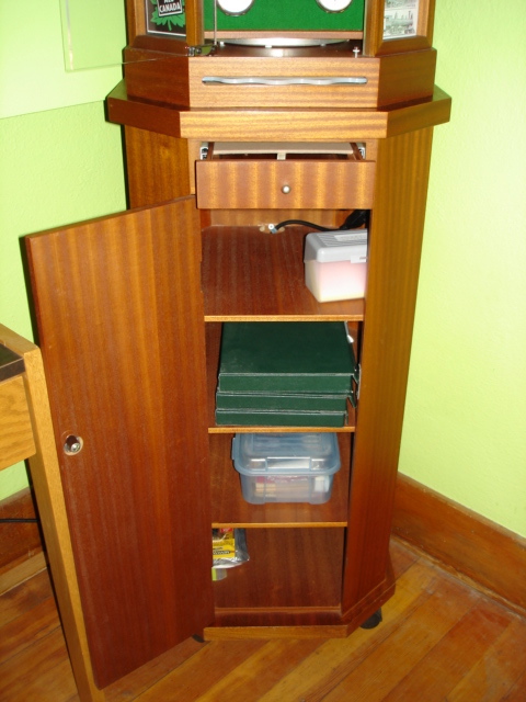

Lorne WasylishenThe base has a small drawer and cabinet with lots of storage.
March 04, 2014, 10:33

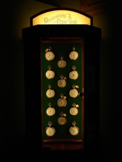

Lorne WasylishenLighted in an otherwise dark room.
March 04, 2014, 10:34
Lorne WasylishenI am pretty happy with the whole project.

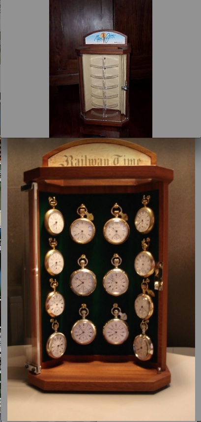

Lorne WasylishenI scored another one of these but this one is only 20" high and 11" square. (678)
No power to this one but I hope to find suitable battery powered LED lights for it as there is a depression in the top of each side that should fit them.
As is now, 14 watches on this side and 16 on the other, just a titch short to fit 4 of the bigger 18s pieces.
Unlike the bigger one where the pedestal rotates inside the outer housing, this entire case rotates.
I love doing these, most fun you can have without laughing but must admit to a few joyful chuckles when doing this one.

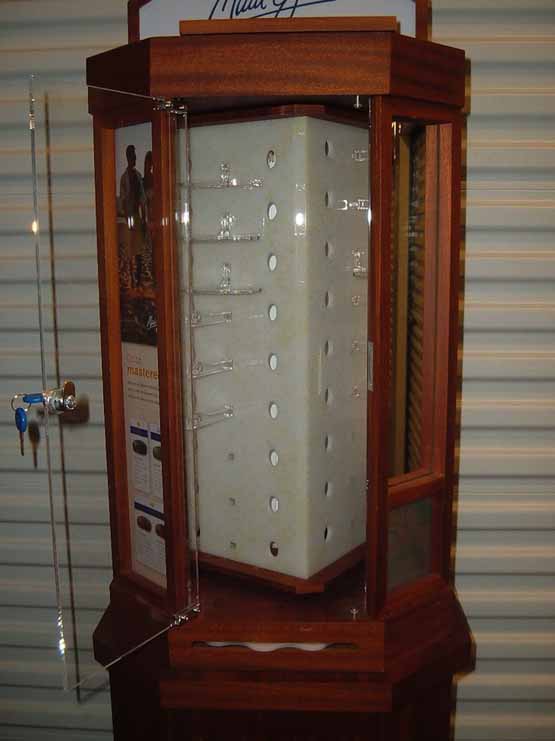

Maui Jim DisplaysThe ones I used were made by
Chippenhook.
I have another newer version seen below (just the top part) but it is sitting out on the front porch covered with plastic.
The Maui Jim representative in Vancouver was very good about helping me out with acquiring the one I did for Bill Manders.
When they changed to a newer version the rep went around delivering the new ones and picking up the old ones of which most went to the landfill.
He held one for me and a buddy picked it up and trailered it here for me.
