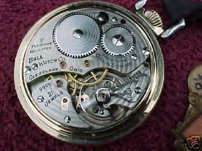

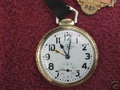

Sheila GilbertWhy does this Ball 999B have 3 hands?
This is a 999B and I would like to know why it has 3 hands? Sorry for the bad pictures.

Larry SoucheckShelia, the red hand is a common second timezone hand found on many watches. They could be set at any other hour position and moved in unison with the standard hour hand.
Not all all different from the modern day rotating bezel on a wristwatch
July 22, 2005, 22:42
Tom McIntyreIf an operating crew member worked a long run where the train crossed time zones, the hands were used to quickly show the time in the current zone. They would be set to reflect the two zones and would be one hour apart.
Other than railroad service, they could be set to anything.

Sheila GilbertLarry, Tom,
Thank you, I have seen three hands before but they were different than this one.
I couldn't even tell that one hand is red! This computer needs to be shot!
Thank you for the information, I always wondered why some had these types of hands.

Don't shoot that PC yet. Those additional time zone hour hands were sometimes gold finish and sometimes red to denote the different time zone from the standard blue or black hour hand that matched the minute hand. I believe they are found in either gold or red (I've had both types)--the main thing was to make an easy, instant contrast from the first hour hand when entering the neighboring time zone and then keeping time by the other distinct color of hour hand.

Patrick McCarthyQuestion - How is this third hand set? Is there an extra position on the lever?
Pat McCarthy
July 25, 2005, 11:45
Aaron BereiterPat, the third hand is actually part of the first blue hour hand. (At least the one I have is) It moves synchronus with the primary hour hand.
July 25, 2005, 12:33
Larry K. BurwellPat,
Aaron is correct. The two hour hands are actually crimped together as one and spaced one hour apart--so the watch's time is set like any other watch.
July 25, 2005, 14:33
Patrick McCarthyAaron and Larry - Thank you. I misunderstood "Larry S #1"'s response indicating the second hand could be set to "any other hour position".
Thanks for the clarification.
Pat
July 25, 2005, 16:34
Tom McIntyreIn principle, you could set them to any angle apart by releasing the crimp and turning one hand, I think. Some of them may have only a single hub. In practice, they only need the one hour separation.

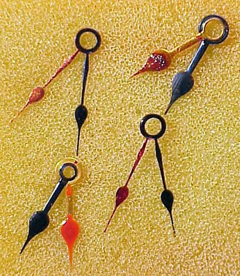

July 26, 2005, 09:45
Tom McIntyreIt is possible that Sherry is confused and believes you need both hour and minute hands for the dual time zone set. The heavy spade hands could be taken for hour hands and the light spade hands as minute hands. They are, of course, all hour hands for different styles of dial.
It is interesting to note that the lower left set is for an westbound run while the other three are for trains originating in the west and traveling east. The "home" hand is conventionally the blue (or black) one.
