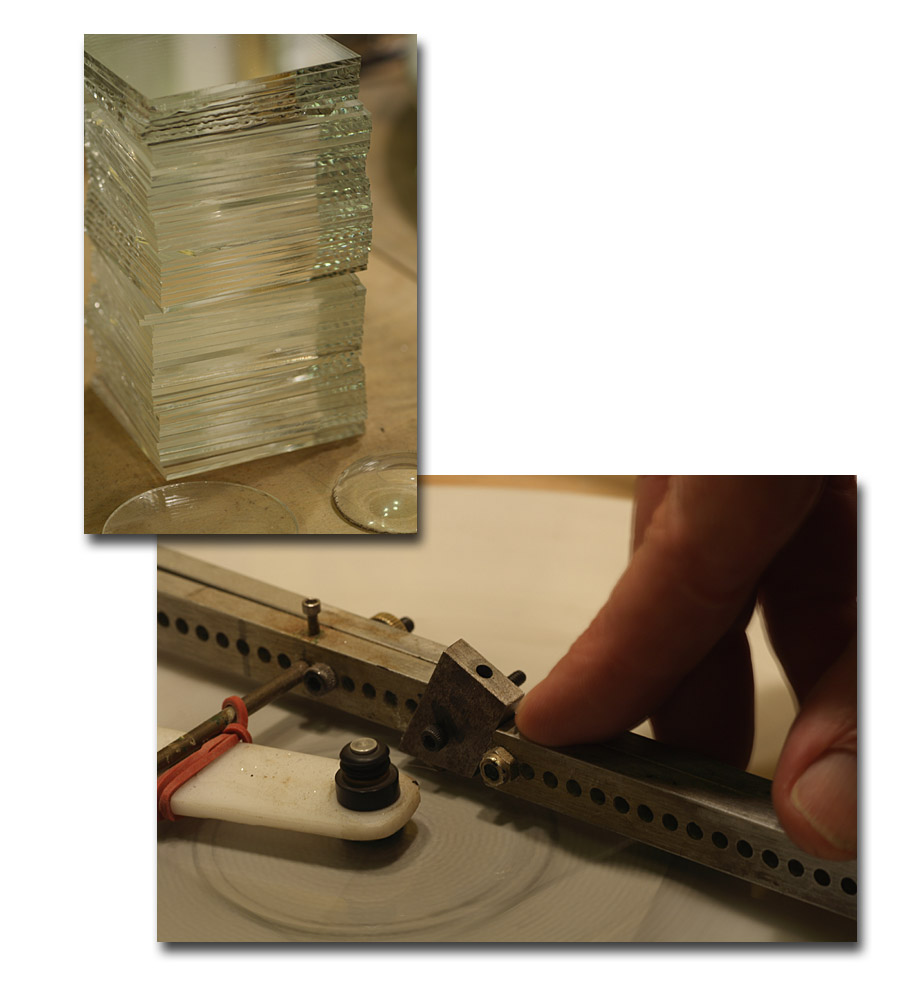

William D. WhiteI think the obvious place to start is with the types of sheet glass that are used. The first requirement is that the glass I select be as clear as possible and free of any edge color. Common soda lime glass although workable will not produce suitable watch material due to its high iron content and resultant aqua hue.
Most commercially available flat glass is produced in 2 different ways. The first and most common is made using the “float” process wherein molten glass is poured onto a bed of molten tin where it floats on top and cools leaving very flat, smooth and parallel surfaces. The benefit to this process is also that the glass can be output continuously around the clock. This is how common soda lime glass is produced but other formulations are also made using this process. The second type of flat glass is formed by drawing the molten product through a wide, flat slotted die and is referred to as “drawn sheet”.
I currently use 3 different types of glass for the different crystals I make:
The first is is a drawn sheet known as “water white” or “mineral”. The formulation and properties are similar to soda lime and while not optically clear, the gray-green edge color is very faint and nearly invisible with something as small as a watch crystal. The kind I use is manufactured by Electroverre in Romont, Switzerland. I believe that China has also been making a similar product for some time. Water white glass has been used for many years in the production of microscope slides, photographic slide cover glasses and of course, watch crystals. It is still used widely today and I use it for thin to medium convex beveled edge crystals 1.0, 1.2, & 1.5mm thick, Mi-Chevee style crystals 1.0 & 1.2mm thick and custom high dome fusee and bullseye crystals.
The second is a low iron float glass called Optiwhite made by Pilkington in the UK. I use this in 2.0, 3.0, & 4.0mm thickness for larger timepieces where heavier flat or convex crystals are needed. This glass is very clear and lends itself perfectly to this application.
The third is a float glass made by Schott in Germany and known as Borofloat. This is perhaps the most exotic and clearest glass I use. The formulation is borosilicate and is nearly identical to Pyrex made by Corning. It has a much harder surface and a higher softening point than the other 2 types I use but it is simply a joy to work with and results in some terribly beautiful watch crystals. I use this type almost exclusively for 1.7mm thick 16 size RR crystals.
January 08, 2010, 00:11
William D. WhiteThe first step in making a typical batch of 1.7mm borosilicate 16 size watch crystals is to cut large sheets into smaller 2 1/4” squares. Due to the hard surface of this glass a diamond hand held cutter with oil must be used to make an effective score. Once a good stock of small squares has been cut, (I usually cut about 200 at a time) 48mm diameter circles must be made from them. For this I use a heavy turntable with an indexable cutting arm which is also equipped with a diamond tipped cutter. I bear down lightly on the cutting arm which also holds the piece securely at the center and give the turntable 1 full spin. After applying pressure on the opposite side to develop the crack, the outer portion can be easily removed leaving a flat 48mm circle.

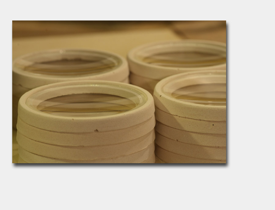

William D. WhiteNext the circles must have their sharp edges ground smooth so they can be safely handled during cleaning. The spotless blanks are now placed into special refractory plaster ring shaped molds which support the glass by the edges only. The molds with glass are now loaded 24 at a time into a small, fully programmable kiln and heated to 1310 degreed F. At this temperature the force of gravity causes the now soft glass to slump into a slightly concave form. Once the firing is done and the glass has fully annealed by cooling slowly, the kiln can be unloaded and the process repeated.

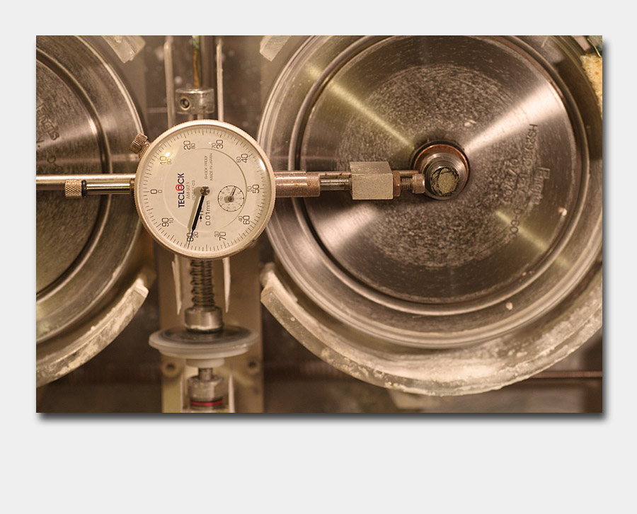

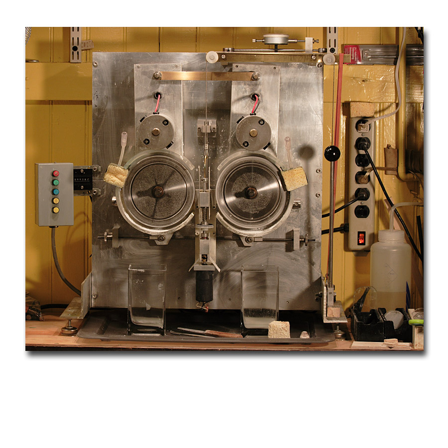

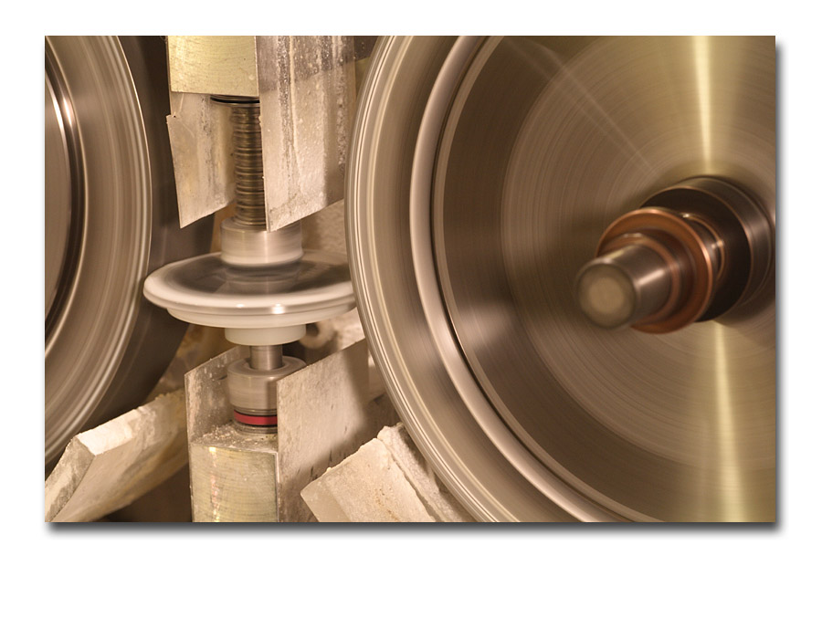

William D. WhiteThe next step in the process is to take the 48mm convex “blanks” and reduce them to the exact desired diameter by machine grinding. The machine I designed, built and use for this is probably the one piece of equipment that took the longest to develop but I think I did everything right (for a change) because the thing works like a charm every time. Basically, It features 2 independently driven vertically mounted 6x1 1/2” heavy sintered diamond wheels. They turn at about 2,500rpm in opposite directions so that both cutting surfaces are traveling downward. The piece to be ground rotates horizontally and is fed upwards into the wheel gap. I built this machine very heavily for stability and accuracy and only top quality drive components were used for continuous duty and reliability. I have also applied for a patent on this machine since I do believe it to be a unique approach but most importantly, it has a feed handle like a “one armed bandit” which makes it fun to use.
William D. WhiteThis fixture is used to quickly set up the distance between the 2 wheels. (finished diameter).

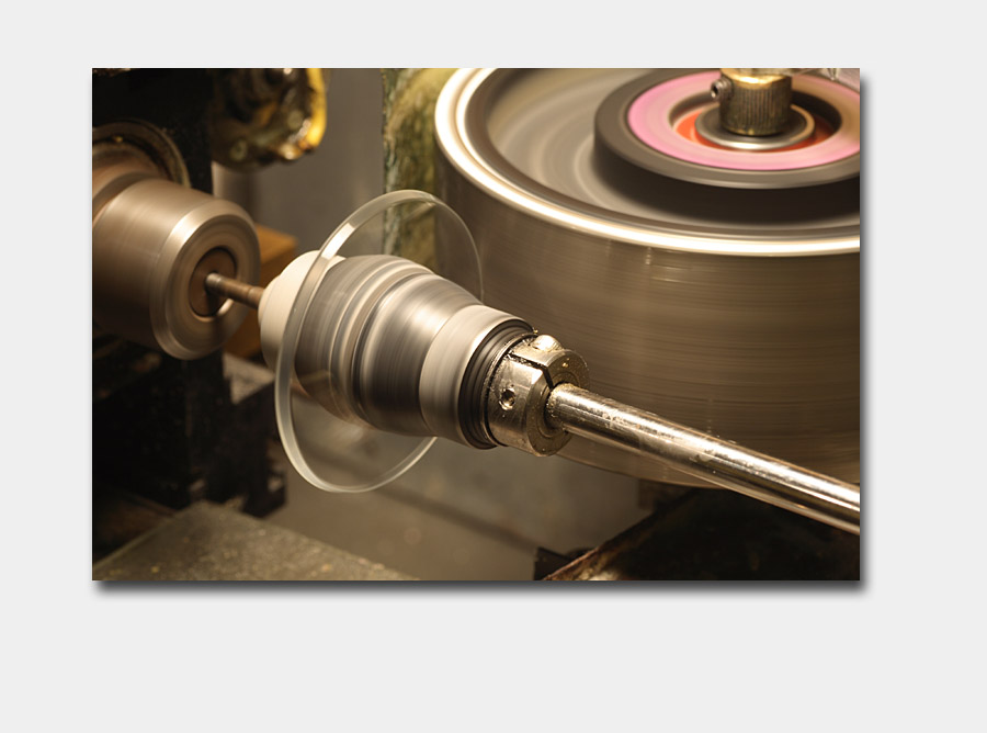

William D. WhiteAt this point the center drive holding the rough blank is introduced upwards into the cutting surfaces of the 2 diamond wheels. The center which rotates at about 200 rpm is also free to articulate from left to right which not only allows both wheels to do exactly the same amount of work but also provides the assurance of a perfect circle even if the blank is positioned off center. This machine is pretty aggressive and a 48mm blank can be ground to 43mm in less than 1 minute. Once the piece is reduced to the same dimension as the gap between the wheels, it simply exits above. I'm happy to say that this machine consistently produces close tolerances of the finished piece: the first cut is +/- .03mm of the initial dial reading and repeatability is +/- .01mm.
January 08, 2010, 00:12
William D. WhiteThe final step is beveling and finishing. Here a basic mini lathe has been converted to accomplish this task. Using a 4” plated diamond wheel set to a predetermined angle, the bevel is ground. The crystal is then turned around so that the bottom can be chamfered which removes any tiny chips left by the diameter grinding process. A prefinish is now applied to the bevel and finally, a small piece of heavy felt charged with a thick cerium oxide slurry is held against the beveled edge which soon gets hot and produces a brilliant finish.
