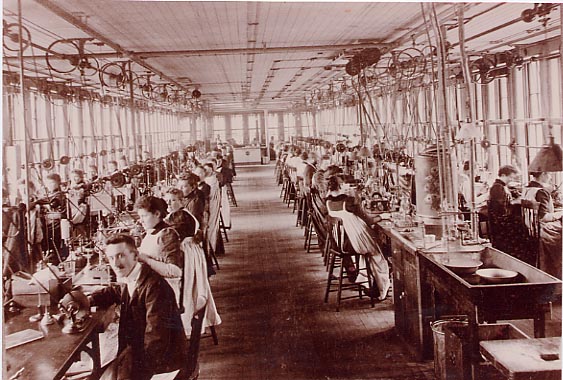

Bob Tasciones tapes are excellent for beginners. It would be great for the organization to have more women involved in watchmaking... Most of these watches were assembled by women workers. For proof, here's a picture from the Waltham Watch Factory.

Stephanie O'NeilI thoroughly enjoyed the photo of the employees of the Waltham plant. (I wonder what their salaries were at the time?) How interesting! Do you have more pics you can share?
And you are right, quite a lot of women involved in the production of pocketwatches at that time.
Do you have any idea what year this pic is from?
A little more encouragement by looking at the photo of women employees thanks to you.

Jerry Treimanfrom an 1885 pamphlet about the American Watch Co. (Waltham):
"For certain kinds of work female operatives are preferred, on account of their greater delicacy and rapidity of manipulation; and it should be added that woment get the same wages as men for doing the same kind and amount of work"

This gets even more interesting! Women in the work force in 1885 is a surprise much less the same amount of wages as men! Hummmmmmm! I'm glad to read that. I'm also glad to read about women's delicacy and rapidity of manipulation!-in the pocketwatch work force that is.
Huummmmmmmm!Maybe I will be able to clean and oil!Thanks Jerry. Anyone else?
