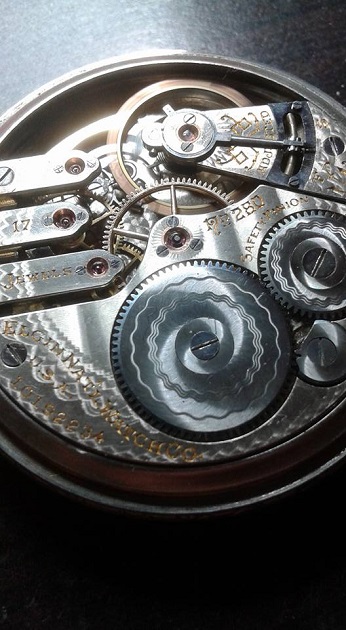

Just for curiosity sake........What is the difference between a common 17j three finger bridge model and one marked GM Weeler?

a lot better movement, adjusted, gold jewels setting, gold center wheel
better grade less made

Thank you I have several 17j 3 finger bridge models and 2 are GM Weeler's and they all appear to run the same and yes they are all COA nice movements if I may say

compare the jewels setting you will notice the difference on the other hand grade 280 is 3 fingers 17 jewels also but RRG

I have a 280 the only difference I can see is that it is lever set but that is not a GM Weeler Again I say thank you for your input. Not tonight but tomorrow I will have a good look at both. I think the 3 finger bridge mvmts are wonderful I also have the 15j and 21j and I will ask a couple of questions on the 2 21j mvmts that i have.

As Peter said, it has to do with quality. To add to his comment and relay some information to you, Elgin remains the "King" when it comes to nameless watches. B.W. Raymond was the Railroader's watch, while the G.M. Wheeler was the Gentleman's watch. Before grade numbers were introduced, names were used by watchmakers to order parts. The names generally implied a certain level of quality. Not all G.M. Wheeler's were the same quality, but they were usually higher quality than nameless grades. The G.M. Wheeler's that were made were always of lower quality than the B.W. Raymond's. Names were used on different grades, different sizes, and models.
By 1877 over 90% of Elgin movements sold were nameless with only "Elgin" and the serial number on them. Actually B.W.Raymond, H.H.Taylor, and G.M.Wheeler were merely registered "Trade Marks" that Elgin started using on their watches back then and would remain over the years.
